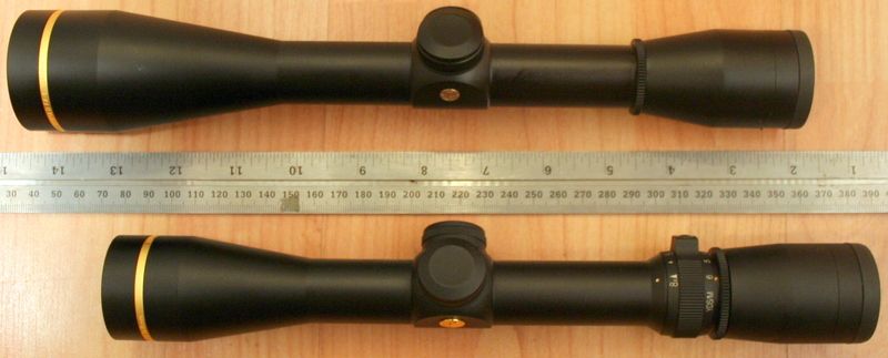

I weighed both scopes and they're much closer than the Leupold specs indicated:
VX-3 2.5-8x36 is 11.2oz (Leupold lists it at 11.4oz)
FX-3 6x42 is 11.4oz (Leupold lists it at 13.6oz)
So weight difference is a wash. The tube length is also very similar, with the VX-3 being < 1/2" shorter --- the main difference is in the erector position and the added zoom ring:

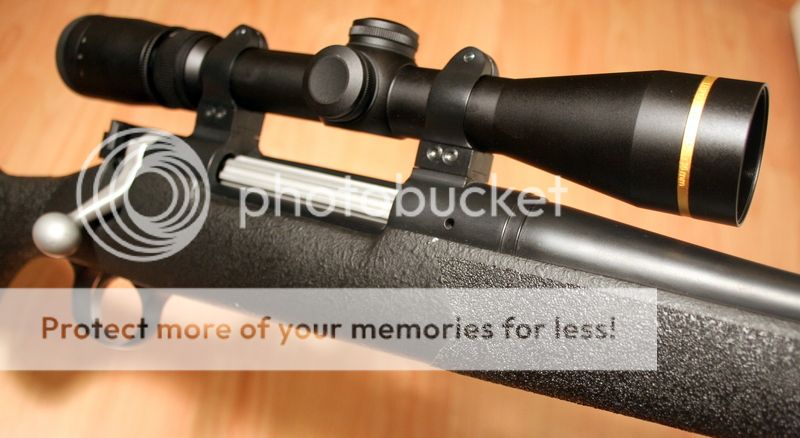

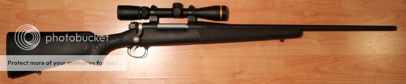

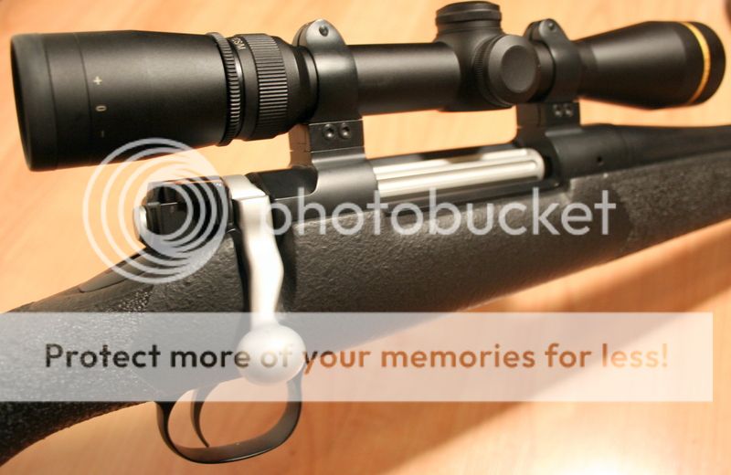

I did a test fit of the 2.5-8x36 on my Remington 700 LA, and the scope fits well enough that I get a full sight picture at both 8x and 2.5x. If I had my way, I'd actually move the scope forward another 1/4", but that's not possible due to the rear ring abutting the zoom. Here are pictures of the setup as it currently sits... scoped, but unloaded, this weighs in at 6lb 11oz:
