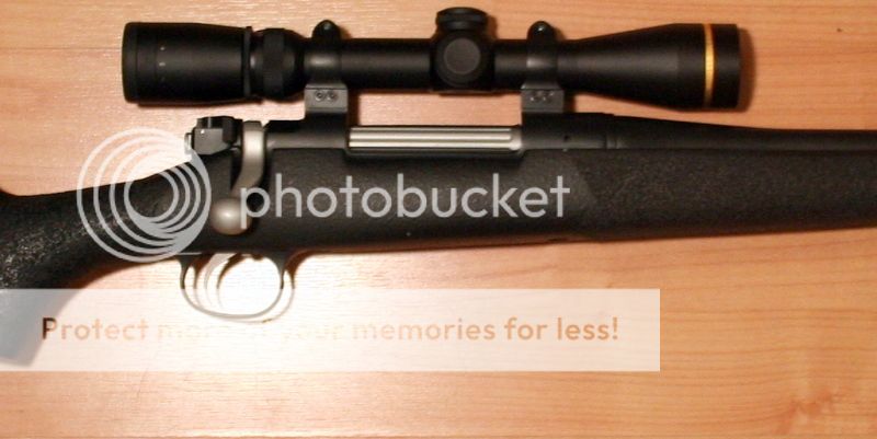

Foolishly, I hadn't even thought about the impact of tube length. I know the 6x42 fits nicely forward on the rifle as it has a relatively long eye relief. Fitment is going to be concern, and I'll have to wait until I have the 2.5-8x36 on hand to see how it goes. The 270 is a Remington 700 that has quite a bit of machining done to its receiver and had Warne Premier bases shaped and permanently installed. The Warnes a from the late 80's, I believe, and are not Weaver-compatible, so I'm pretty much stuck with the standard 1" rings that came with the rifle... so no flexibility to go with extended rings.

Looks like the bolt body was custom fluted, a longer bolt handle replaced the factory one, and the 3 position safety might be a Gentry. The scope bases appear to be integral, so must be welded in place, then machined to hide the seam, and some bulk was trimmed off the rear receiver ring, nice rig!

Boomer got it pretty much right. A fellow CGNer put this rifle up on the EE along with identical ones in 7RM and 300Wby. The 3pos safety is a design by Ed Lapour (http://edlapourgunsmithing.com/), who also did the gunsmithing. In addition to what Boomer mentioned, the stock is a lightweight fiberglass (not sure what make) and the blind magazine box has been "honey-combed" to reduce weight. The trigger is a Jewell. The metalwork has a black teflon finish. I think the work was done in the early 90's before there were factory lightweight rifles like the Montana. It's a great handling rifle, and the original owner reported excellent accuracy. I'll be taking it to the range soon to try it out.

I think the FX3 6x42 is going to get the nod, at least for the next range session. I mounted it and found that I really did prefer the eye relief of this scope. The thin recoil pad shortens the LOP to 13 1/4", so for my standing hold, I really wanted to have the scope a bit further forward than the VX3 would allow. The eye relief is longer on the FX3, which moves it quite a bit further forward than the VX3 --- the side benefit is that the safety is extremely easy to manipulate.
Here's a picture of the FX3 6x42 mounted, followed by the VX3 2.5-8x36 mounted:
Aesthetically it's a wash to me: one is simpler and cleaner and one is smaller. The giant dorking objective lens (LOL thanks BigUglyMan! :) ) fills the space between barrel and scope pretty well. Could move it a quarter inch back for looks, but ergonomics come first.
