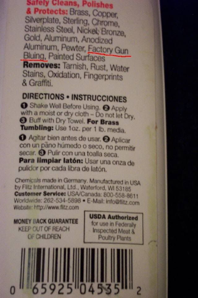

IT's your best friend for anything metal ;)
images
images
