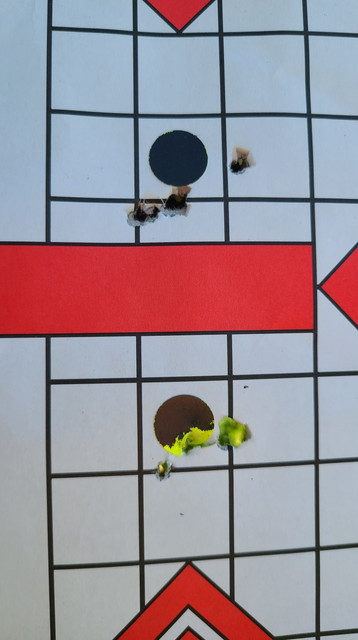

For practice and plinking, I am currently working through a few bricks of RWS Target Rifle which shoots 1 hole groups at 50 all day, well under an inch at 100, and I can somewhat reliably shoot groups under 5" at 300 yards (better when I get a good wind read). It's not as good as Eley Match or RWS 50 or Lapua Center X but it is a LOT cheaper and readily available at tenda, tesro, etc..

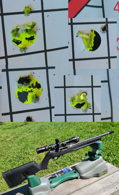

3. Finally and IMPORTANTLY for this thread, I have to give a huge Shout Out to the folks at Grey Birch who have provided me with much higher customer service than I could have expected or, frankly, deserved. They completely looked after me when it was me who messed up. By today's or any standard, I am super impressed. It has been a long time since I have experienced customer care like that. I am absolutely thrilled with my Fusion 16.1 and I eagerly await my fusion RDR (12.5") which I ordered just in time back in May.
