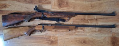

Got my 8M in the mail today. The barrel was turned down and re crowned. The modified front sight is definitely intresting. Must came from a shooting club. As there is a name label on the forearm.
Had some surface rust around the rear sight. But for 270 shipped, I cannot complain.
The stock is nice though.
Photos please!!
Then the weird front sight. Im taking the front sight off my other and putting it on.
Took off about a 1/8"
Between the two, you have a really nice, original condition, rifle. Fantastic stock, as nice as I have seen, on your new rifle. Great barrel with original front sight on your old rifle.
I would suggest putting the rear sight off of the new rifle on the barrel of your old rifle, along with it's original front sight, and put it in you newest stock. :)
Thanks. I cut the sights off my old one, hence the rear peep. I like the profile of the new stock, and seems like it got a better trigger. So the lighter stock one is my new shooter. The old I may slap a scope or something.
