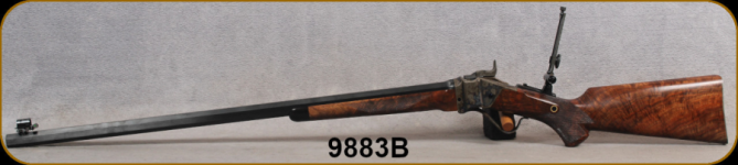

im shooting a Chiapas Quiggly Sharps in 45-70. What are the risks or effects of trimming shorter than the Sammi recommended length? I’m shooting smokeless powders.
Won't matter one bitim shooting a Chiapas Quiggly Sharps in 45-70. What are the risks or effects of trimming shorter than the Sammi recommended length? I’m shooting smokeless powders.
Not at all.........maybeI would assume a shorter case would produce higher pressures but don’t know how much
