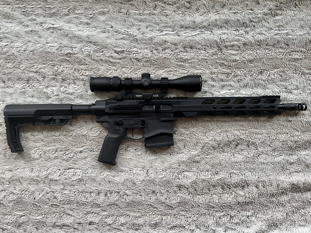

Did Troy make them in 338 Federal? If it was rebarreled that could have had something to do with it. Troy had to flute their chambers to make extraction work on the PAR, right?
Yes and no. Troy initially fluted the PAR chambers thinking that this would aide in primary extraction. Turns out it was unnecessary, and Troy no longer flutes their chambers. My PAR 308 is not fluted and extracts even dirty surplus IVI from 1975 just fine with minimal rearwards effort on the Handguard (VFG). I am not sure if the .223 Chamber that came with my small PAR was fluted as I never fired that Barrel, I immedately swapped it over to .300 Blk, which has fed and extracted/ejected just fine ever since.
As near as I can ascertain from owning both models of PAR, the rumour that they are hard-extracting is patently FALSE. Both models of Troy PAR function easily as intended and designed.
I have no trouble benching the PAR 308 rifle. I just raise the muzzle a couple of inches between shots to rack the pump and cycle the action. Then I lower the rifle back onto the rest and prepare to fire the next shot. I don't find it at all disruptive to the process of accurate shooting. For any field shooting off-bench, the PAR's pump-action is clearly superior to the side-cocking MRA products in terms of both for both speed and simplicity. Both the Renegade and the Matador require the firer to reposition the support hand in order to cycle the action, then replace the support hand on the Handguard. The PAR is much faster in this regard, as the support hand never leaves the Handguard/Pump Handle while cycling the action.
