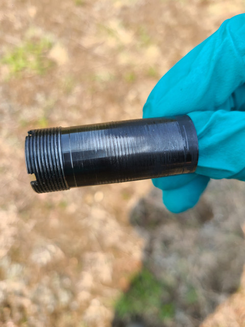

Update on the sulun ss211
Tried shooting steel 3" BB goose loads out of the included MOD choke.
The choke tube was a pain in the arse to remove! You can see the tube was expanded enough to require to unscrew it nearly the entire length because it was so tight against the threads.
I will be trying next time with the improved cylinder. But this might just stay a short range turkey gun after all.
Some Turkish choke tubes are crap. Buy the equivalent chokes made by another reputable brand and you’ll be fine. That choke looks to be a mobilchoke. Mobilchokes are very easy to find. Look on the EE for factory Beretta chokes. Also, Carlson mobilchokes are a dime a dozen and pretty inexpensive.
I figured it was like putting an aftermarket bumper on your car, save a few bucks but it was not made to exact specifications lol ill do as you suggested and look for another couple of mods, thanks!
