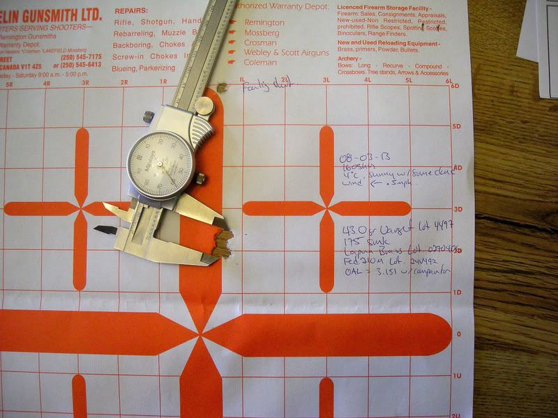

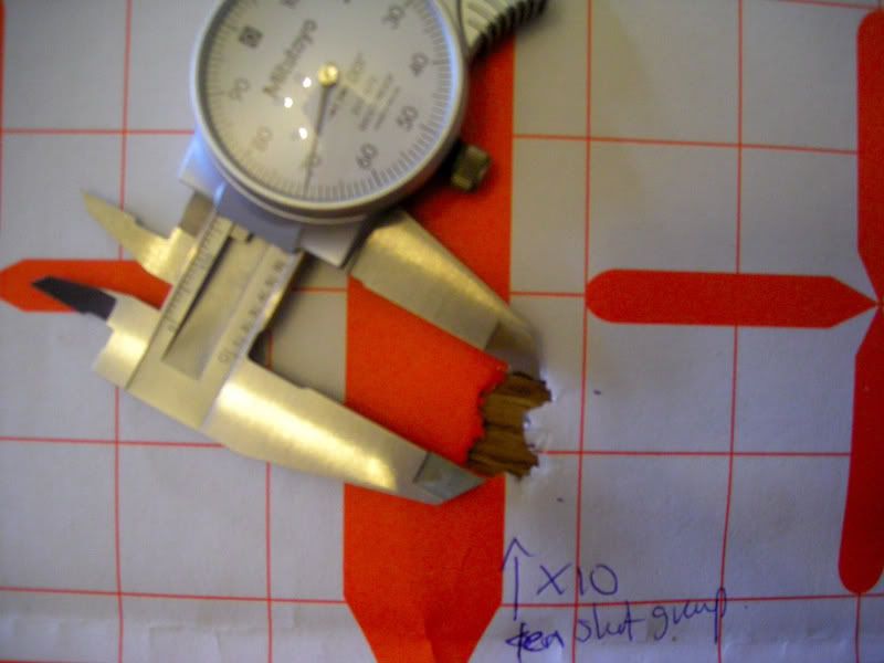

There you have it, measured from outside to outside. Shot at 100m off a Harris bi-pod w/ rear bag.
Can't wait to start load development and see what more I can get out of it.
Are those mag fed? I know we talked already but you have got to cram more powder in those casings. It's expected of you. No less then 46.5gr with 175gr SMK
I gun juiced the gun (10 rounds). Adjusted zero. Cleaned the pipe until fully clean (patches only, no brush). Then ran one fouling shot throught aiming for top dead center.
The rest is history,,, I loaded up the mag (10 rounds), shouldered the gun and let-er-rip,,, all 10 rounds.
These were mag fed, should be 2.845 COAL or 3.151 w/ comparator.
Now I'll start ramping up load development:D
Thus far at 100m it puts the bullet where you point it:cool:
