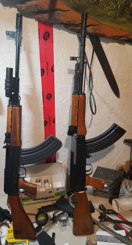

I’ve done some more measurements on my bent fixed. The receiver looks to have only a slight bend at the front trunion, it then starts to curve slightly going back. The bolt runs smoothly for the entire length tho. (Shrugs) looking down the muzzle at the extended hammer - it looks centered. Putting the hammer down and sighting thru the muzzle to the hole at the back of the receiver - it’s missaligned by 2-3mm
My fixed is about 2-3mm out at the back of the receiver. My folder is a mm or less out. The eye picks it up fast looking down the fixed stock sights. With the folder I had to disassemble and measure to see that it was out at all - the eye doesn’t pick it up.
I beleave the the fixed is still within spec. It no longer bothers me.

I’d be all over a parts kit. I feel like these are seriously robust rifles, much like my high millage SKS, but if something breaks I’ll be a with a rifle that can only be repaired by a machinist for pins and such.
I noticed my new folder had a loose mag release pin; it can be pushed out with my finger. If that sucker let’s go in the snow - it’d be crappy indeed. I’ll use some loctite on it now.
Parks kits please!
Put some locktite on the rear sight nut too. Mine came apart but I got lucky and found the spring and nut. It's the one that goes through the adjusting knob.
Yeah. I had read that in one of your earlier posts. Mine look pretty well staked but I put some red loctite on the outside of the nut.
Think that’s good enough?
The magazine release pins I partially drove out, degreased, and then applied red loctite before driving back in.

Just support it on a steel drift pin puck and center punch the outside edge of both sides of the pin. Welt the steel out slightly and it won't drift out even under hard use comrade.

My fixed is very nice looking. My folder is more practical, easier to tuck into the sights, and the stock has fanatastic lockup. - I wouldn’t know what one I’d choose if I could only have one.
Check you’re mag release pin.
Check your sight adjustment nut for proper staking.
