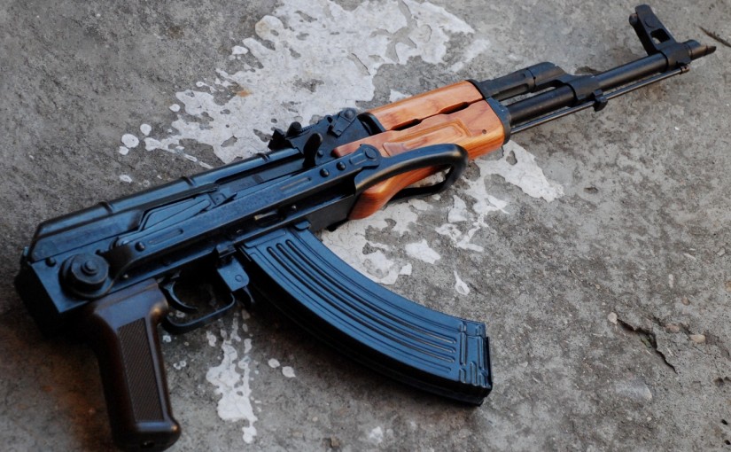

Looks good. I was considering doing the same with one of the Vz58 folders I have in my parts bin if I get tired of the fixed stock.
I decided to go with the ZHUKOV-S stock instead. Looks like it will also be easier as I won't have to make an adapter plate . I cant seem to find anyone who did this mod. Also settled on a Bakelite grip.
I love the look of AKs that have black stocks, plum grips and light coloured wood forends. Looks like 0 ####s are given, witch is right up my alley :)
