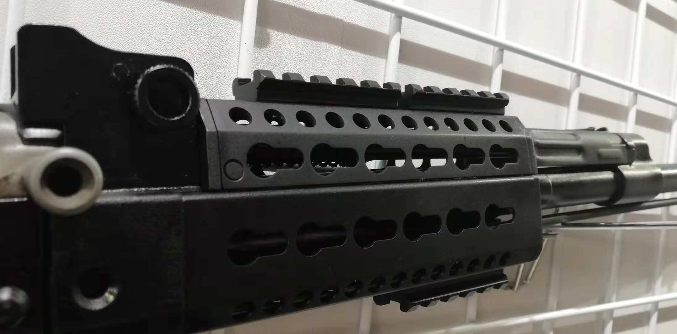

I just discovered the cleaning kit in the folding stock. I was trying to figure out how to change the dark color handguards with the lighter ones TI provided and it popped out. Cool. Rather ingenious place for it.
Pretty much DONE.... other than a tiny squirt of black spray paint.

ethan or b43ma would a magpul moe ak short handguard be easier to install than the zhukov handguard?
not sure, if the lower handguard retaining ring sits at the same length as AKs, it should be easier.
I cut off the retaining ring right off, and I don't think you can easily re-adjust the position of the ring (forwards or backwards).
Even though you can fit the lower portion of the MOE handguard in position, you may have to adjust the height of the top (upper handguard: gas piston cover piece), and the 81 upper handguard is longer than AKs.
