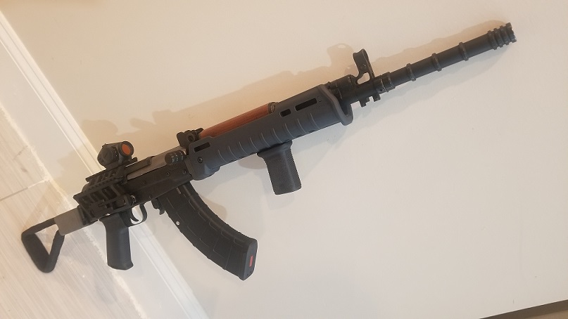

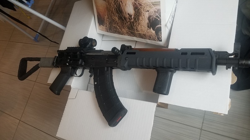

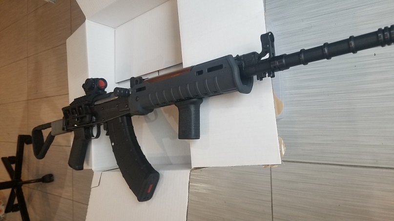

Just got a side plate and side mount for optic,
to do list:
1. find a location for the side plate, on the right side of the receiver, as the left side has a very 'busy' internal structure (safety plate etc.) See concept Pic!
2. insert an aluminium shim between the side plate and the receiver, to avoid the wider steel side plate running into rivets and safety, I don't want to work on steel side plate as it's hard to deal with
3. sanded one surface of the aluminium shim to an angle to compensate the 'bent' receiver
4. cut off the blued area of the shim, drill and threaded the three holes for bolts, make adjustments to the shim where the rivets may obstruct, See Shim Pic
5. test fitting, and if satisfied, drill the same three holes onto the receiver
6. adjusting shim, making sure the shim is levelled, a washer may be needed at this stage
7. get the perfect bolts and nuts, ensure the nuts will not obstruct internal mechanism once tightened
8. lock-tight, side plate on, side mount on, adjust the upper portion of the side mount (RS Regulate), to achieve alignment with open sights (centre!) Hopefully, it will look like this, See Pic

Next step, put a muzzle brake on it! Well worth the investment.
Thanks for posting the pics
I think I'm gonna give this a try too whenever I pick up a T81 again
