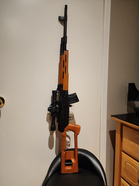

Not satisfied with “well enough” I took a trip to the hardware store and bought some tiny washers to try. I ended up using a 4mm flat washer.
When I put the washer under my 1 inch zinc wood screw the washer deformed nicely to the receiver; the wood stock and the receiver are locked well together at the top of the stock now.
I applied Gorilla glue to the threads and tightened it gingerly making sure not to pull any wood. The washer did not allow the receiver cover to sit back in the rear notch of the receiver, so I used a Dremel to flatten out the top part of the washer a bit, and I also used the Dremel to notch the receiver cover ever so slightly at the back.
A couple trial fits and they mated perfectly, and no modification is noticeable from the outside of the rifle.
A dab of cold-blue and it looks factory.
I’m quite pleased with it.
Snap pics for us.
Funny as I used my last bottle of Perma Blue to blue the Bolt carrier just earlier today and was thinking I should keep it for exactly what you did. Ohwell
Pics are from JeffMan and his mods
The washer he used -
Looks clean. Nice and secure. I might add a washer aswell now
