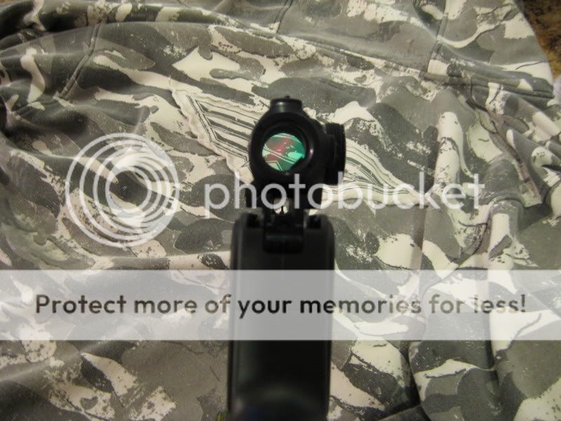

Hi Guys - I thought I would post some pics of some Type 97 optic options. I got a loan of some more optics to test the cheek weld (thanks Shawn357:cheers:). All pics use my see through scope mount.

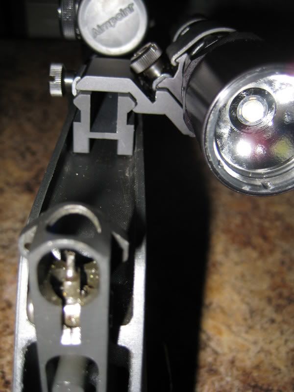

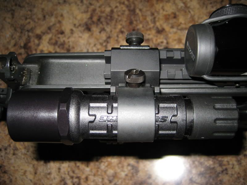

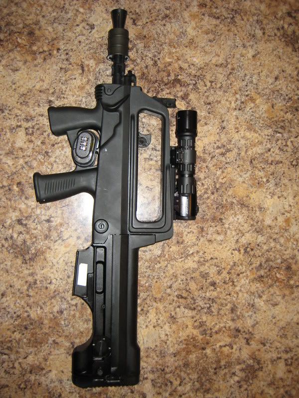

My current set up: Aimpoint Micro. I feel this offers the best cheek weld, a bit higher than a regular cheek weld. A Doctor optic would work well.
I also mounted a Surefire flashlight in an off-set mount (I'm thinking of getting a bunch of these offset mounts made if there is interest).

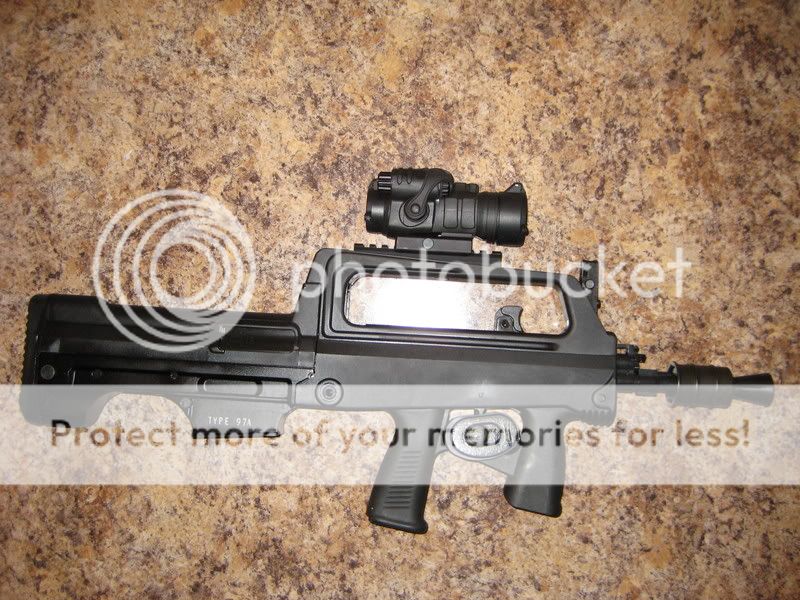

Aimpoint COMPM3 Clone and low mount. This is a decent option. This is of course higher than the micro and is more of a low cheek weld. It wasn't uncomfortable, just higher. I believe you can get an even lower mount for the COMP as well.

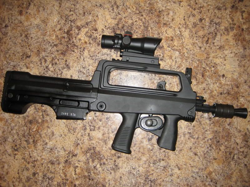

Trijicon Type Clone. This mount was VERY high. More of a high chin weld. It worked but was not ideal.

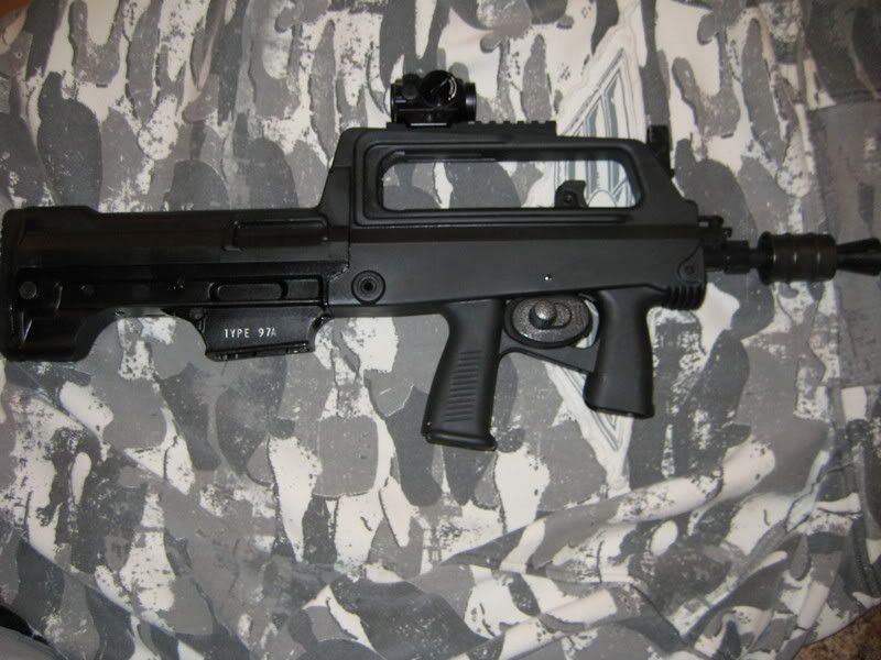

Bushnell Red Dot. This one mounted almost as low as the Micro. It's a real good option for those on a budget. (note: the scope mount in this pic is an airsoft mount)

as far as the side mount is concerned i think it would be nice to have since forward light mounting is a pain on this design.

Hi **** - The problem is keeping your eye far enough away from magnified optics. If you look in my optics post note how far back the Trijicon clone sits. It's about the same as the rear sight. With magnified optics they tend to sit farther back than the Trijicon. So you are actually too close to the scope. That's why to use a magnified optic you may need a rail extension. It's hard to explain without actually seeing it but the LOP of the T97 is fairly short, so your eye sits quite close to the rear sight. If you go through some of the threads and look at some photos of PLA solders and the Type 97/QBZ 95 note how close their eyes are to the rear sight. Then I think you'll get what I mean.
