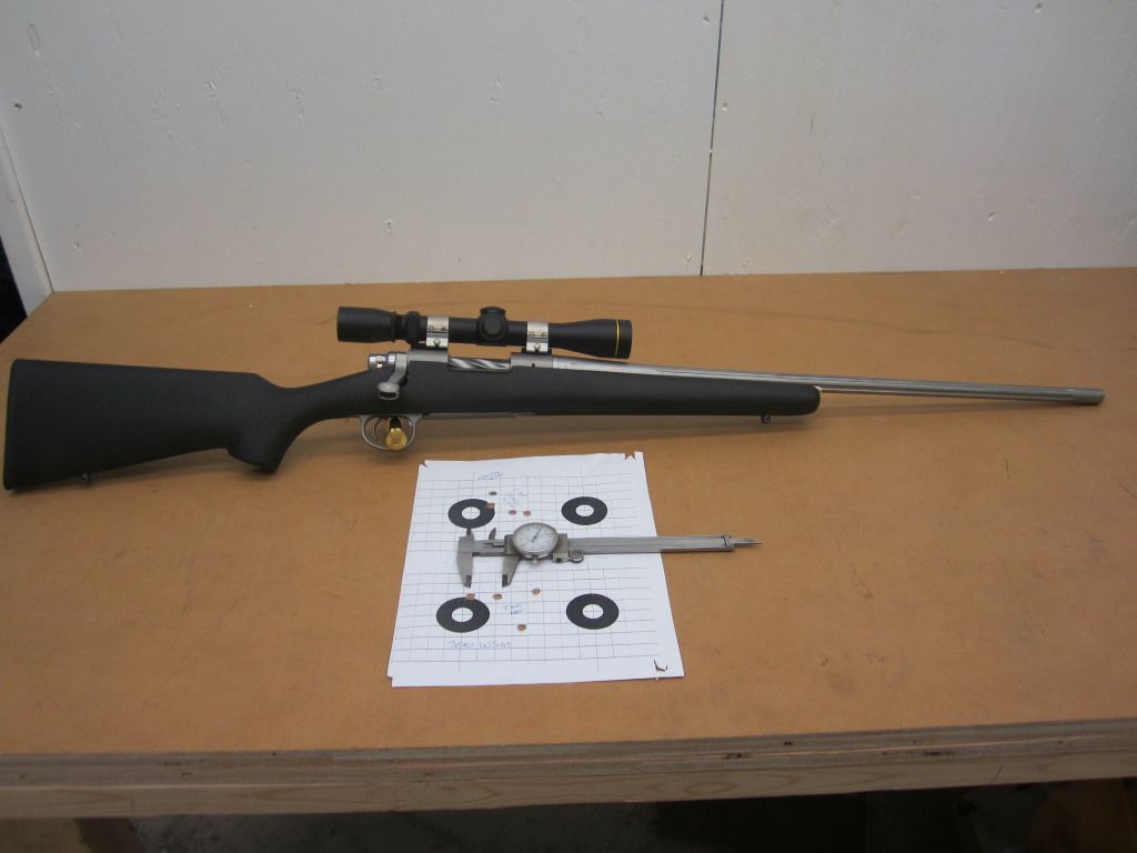

If you had to $2000-$3000 dollars to spend to build a lightweight rifle for carrying while in the bush, what components would you use? I am looking to keep it to a bolt action, short action, and capable of killing deer/moose (likely the .308win will come up quite a bit) and come in at under 7 lbs scoped.
What would be your stock choice? Barrel choice? Action? Scope?
If you have a good example, tell me about it and the cost.
Rem M7 Action -Timney trigger - Pac Nor barrel SS 22" chambered in 7mm-08 or 308 - Wildcat Stock - Talley LW 1 pc rings-bases- Leupold 3-9 Ultralight scope ! Parts + With Gun Smith cost's about $3000.00 - 6 lbs ready to Shoot !RJ
Or, Kimber Mountain Ascent and 4lbs 15oz, with fluted stainless barrel, stainless controlled round feed action with three position wing safety (serious upgrade over Remington), fluted bolt, skeletonized bolt handle, removable muzzle brake (comes with thread protector, so your choice), for $2200. Lighter, arguably cheaper, and a better action to boot.

Being horrendously late to the discussion I'll still offer my never having climbed a mountain opinion. A M70, despite being my favourite platform, wouldn't be my first choice for a purpose built lightweight. If I had to have CRF I would go with one of those sweet little Ti action Mausers from Satterlee. But at about $3K for an action there are alot if ways to get to that result with less financial masochism. Build off an older Remington Ti with a pencil barrel and a Wildcat stock with Talley lightweight and an old Leupold 2-7x lightweight and you'd be logging.

The Satterlees Ti's start at $6k US for the bare action and a 3-4 year lead time right now unfortunately, mine with options is at about $8,500US. Got the first seriously in progress pics of it and it's coming along, just sent him my Ti rings for lapping. Going to look into shaving a Krieger I have here to bottom basement proportions, no safety factor dimensions. Want a rifle that points like a magic death wand in the end.
