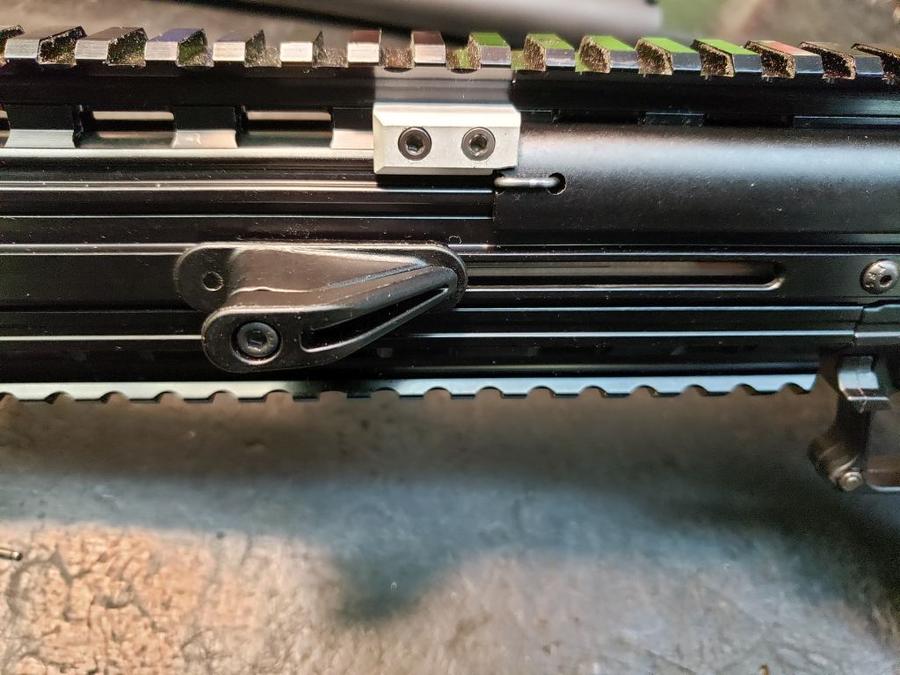

Morning guys. So, to answer the GSG-16 vs. CMR-30 stock pinning question. The GSG-16 is already non-restricted and therefore we simply swapped barrels and modified the 'stock' to maintain minimum OAL. There was no change of status needed. However. To change the status of a Restricted firearms the firearm cannot have been modified by reducing cutting, sawing blah blah to the rear portion of the gun. There is NO mention of swapping barrels to make it a longer OAL. We originally tried to come up with something more simple and user friendly to install :
We made this nifty little block that screws between a slot under the Picatinny rail on the top which limits the stock movement. Once black Loctite has been applied this thing would need to be machined out to remove it. We asked the RCMP Lab if this was cool and were told flat out 'No', because of the rule I mentioned above, and that ended that idea. This kind of had us scratching our heads because this was exactly the same method of making the rifle N/R as what another company had done which is when were told "Why do you think they aren't bring more in if it was kosher with the RCMP ?" There is currently NOT an FRT number for a non-restricted CMR-30. I did however send the a Verification Report yesterday informing them of what we did to this rifle, along with the barrel length and OAL dimensions so hopefully a child entry will be forthcoming soon.

We cannot make a longer hand guard, sorry Mr. Files, simply because the body of the gun is an extrusion and we would need to sink serious dough into getting dies made to have our own extrusion to play with. Pretty sure Kel Tec isn't going to sell us some of theirs although since we are friendly with the official Canadian distributor I suppose I could ask....
I just love how everyone was backseat driving on DLASK about "just pin the stock!" when that was the first thing they tried to do lol.
