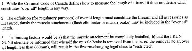

This will bring clarification to your false statements and fabricated criminal allegations.
The criminal code and the Canadian Firearms Program state that a rimfire rifle having a length greater than 26” or 660mm falls under the classification as NON RESTRICTED.
Although this being the case there is nothing outlining what is acceptable to the RCMP to achieve an overall length of 660mm.
Further clarification was sought through Specialized Firearms Support Services as to what is considered acceptable in achieving said length.
The following is an excerpt from detailed correspondence from Specialized Firearms Support Services outlining what is deemed as acceptable practice for the classification of overall length.
These rifles included a muzzle attachment and permanently restricting the collapsible stock to ensure that the rifle maintained an overall length of 660mm.
We kindly ask that you retract your false statements and allegations.
Govern yourself accordingly.
The IRUNGUNS Team
The IRUNGUNS Team
