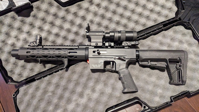

Thank you very much! I can confirm that a TUF-22 and an XB-2 with the shortest barrel you sell and a stock with a reasonable LOP comes out at 26.5" and wanted to confirm I didn't need to find a longer stock. Fun little rifle, highly recommended!
(Dab of blue loctite in the muzzle threads just to stay safe)

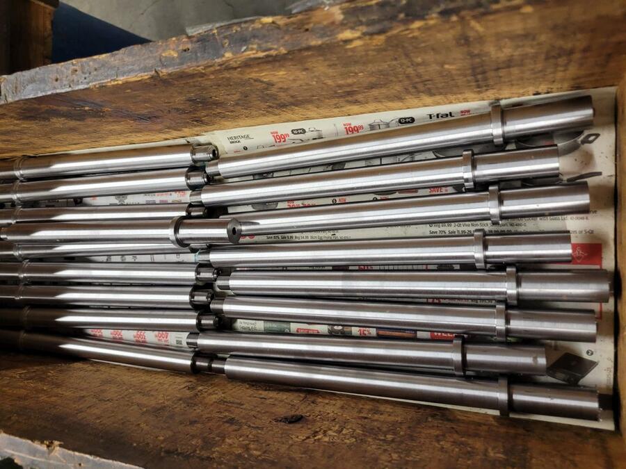

Sorry guys, been a very busy week here. Anyways here is your Leap Day update :

The barrels are now in the shop and I will crown and start to machine the trunnion potion today. It will still be a few weeks so please don't get over excited but I wanted to give y'all an quick update on where we are at.
qué es esto ? (that's French for What is this ?)

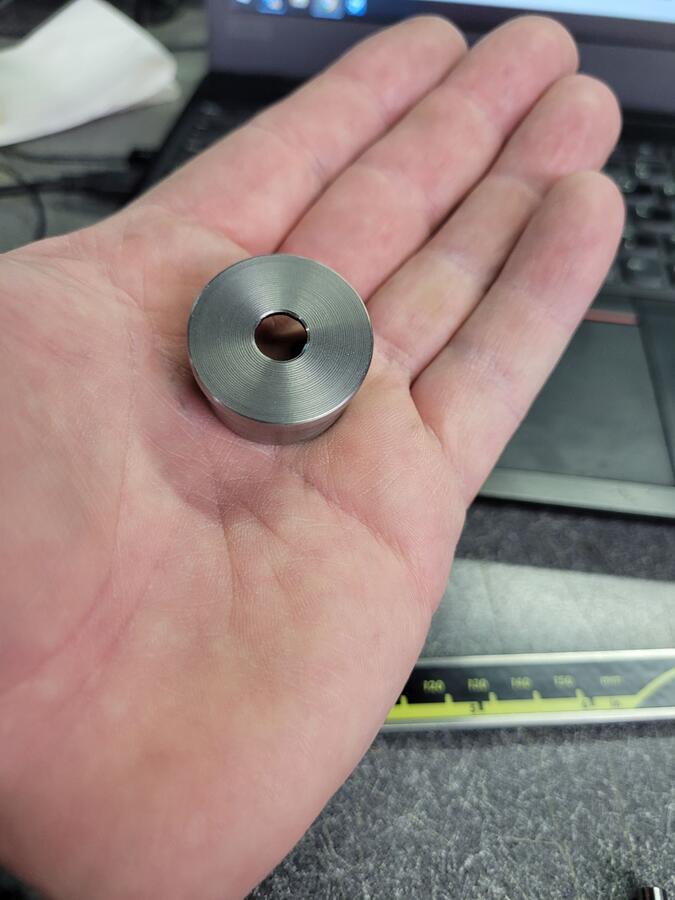

Please note, since this has been asked many times, you can use EITHER a Mil-Spec or Comm-Spec buffer tube, the threads on the receiver are the same size and pitch. The only difference is the diameter of the tube itself. However, you will need to modify ANY aftermarket buffer tube since they all have a lip at the 6 o'clock position to hold in the buffer retainer plunger and spring on an actual AR-15. This lip need to be removed if you use it on the Derya and we HIGHLY recommend having someone make a custom plug for the front of the tube to better support the Loonie size rubber buffer disc that comes with the gun. Here is a pic of the one we spun off for our shop rifle :
Can you explain this a bit more Leigh? Does that go in between the tube and the buffer disk? I just swapped out to a milspec tube...didn't cross my mind that something else should have been done.
I can see the walls of the Derya tube are quite a bit thicker than any of the regular AR tubes I've got laying around...does the rubber buffer just impact against the open end of the tube?
Would 3d printing and gluing in a plug work if we don't have the skills to machine up such a swanky plug?
