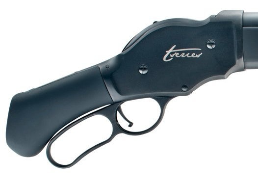

Would it be possible to put this style stock/grip on a mare's leg or would it lead to legality issues?
http://www.chiappafirearms.com/product/2477
Not if they are the same lenght as the original ! the overall lenght must be the same or longer not shorter!
