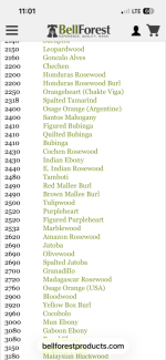

If it's a hunting rifle, it's gonna be very heavy.
I have never worked with purple heart, but it may be a b itch to work with.

The wood is extremely hard and heavy...and requires carbide teeth to cut. Inletting could be a challenge.
I would think that unless used on a DG rifle, that it would be heavier than wanted for regular spot and stalk hunting. If hunting from a blind or a stand where it isn't carried much, might be OK.
