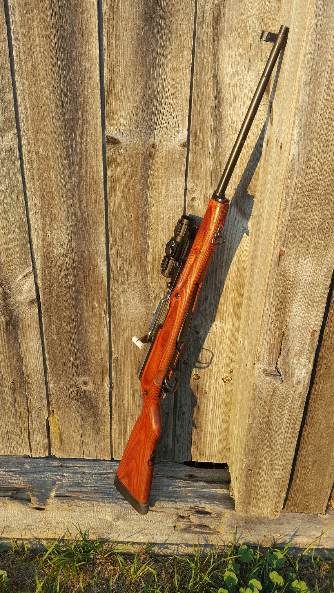

Latest project is converting a 5 shot semi-auto SKS to a 5 shot straight pull bolt action rifle.
No collector SKS was hurt in the making of this latest project, a junker was found and rebuilt.
Okay, step one

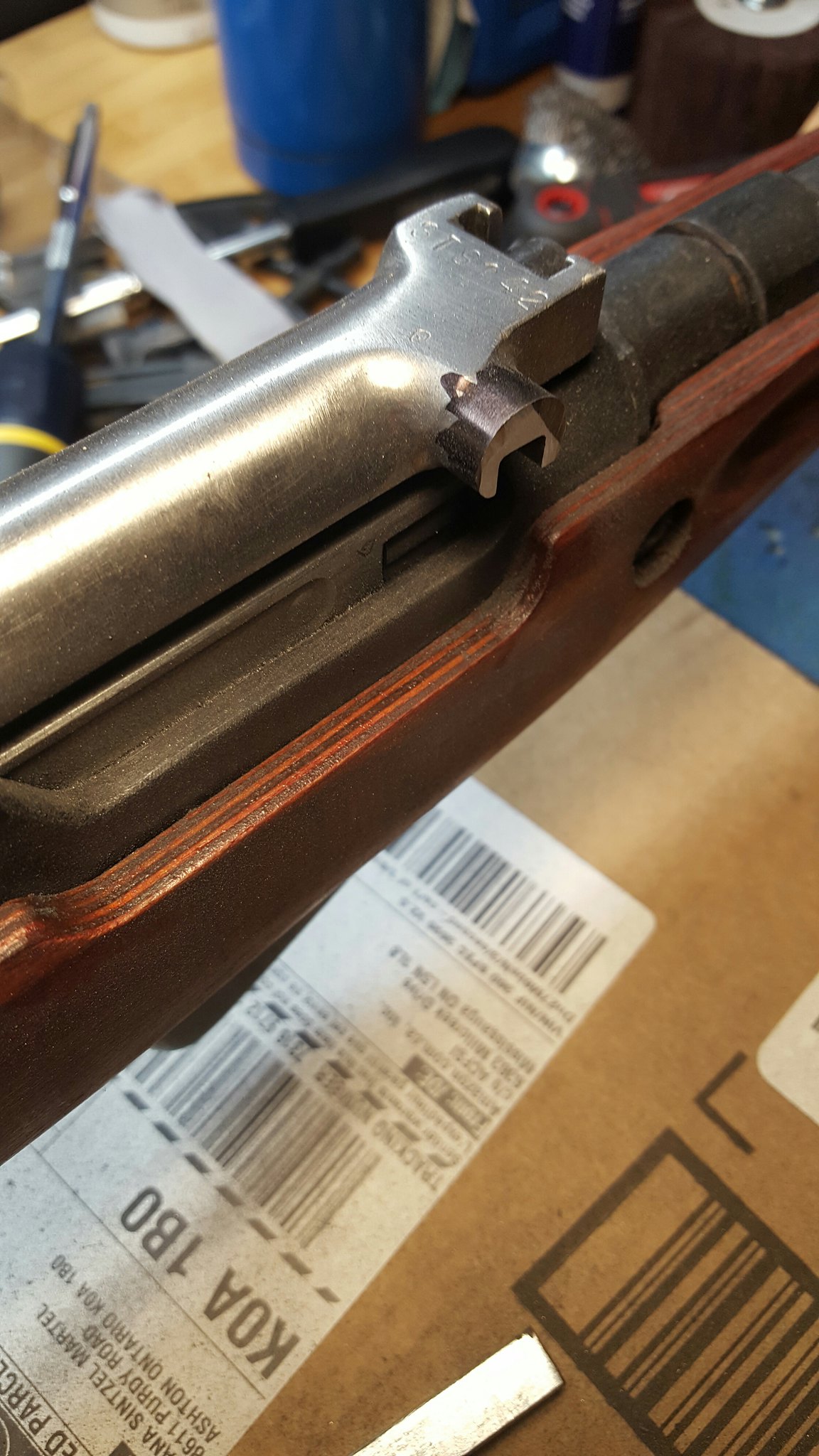

Remove everything that's forward of the receiver that is attached to the barrel with the exception of the rear sight which also is the magazine fore latch.
Gone forever.....the bayonet and front sight assembly, the gas tube and rod, grind down the rear sight, plug the port in the top of the barrel, weld the receiver gas sleeve permanent so you no longer have the makings of a semi.
You now have a straight pull bolt action rifle.

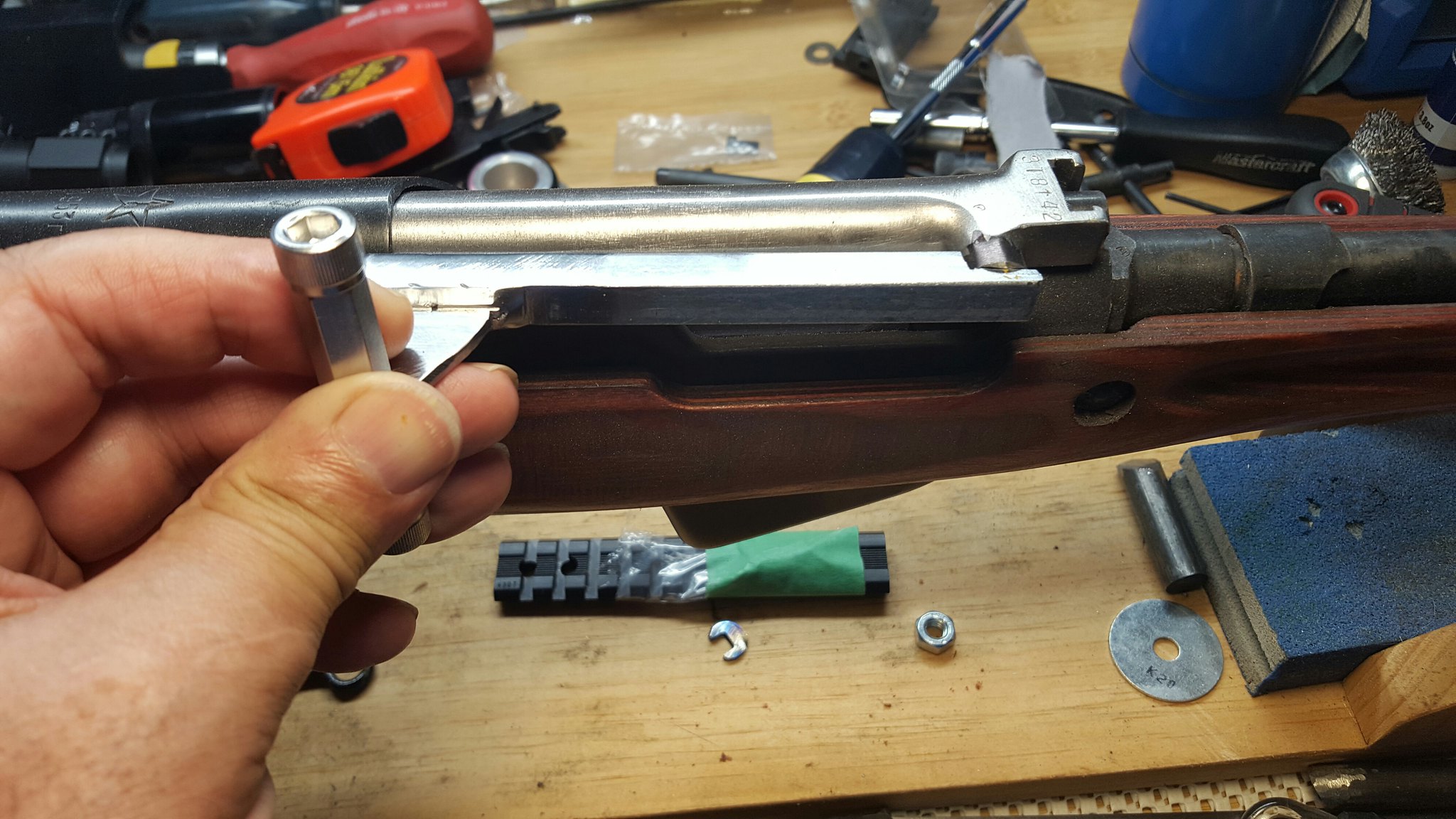

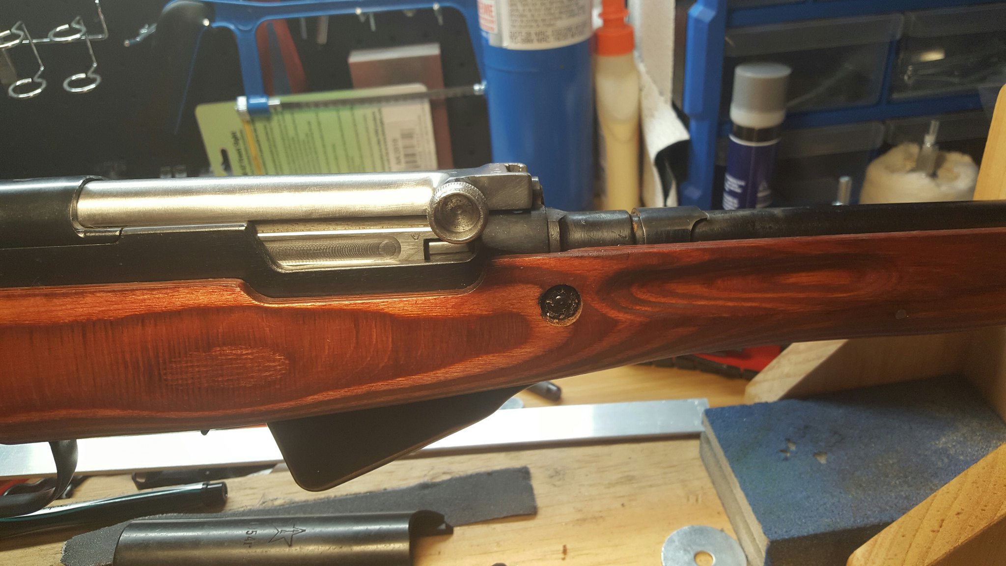

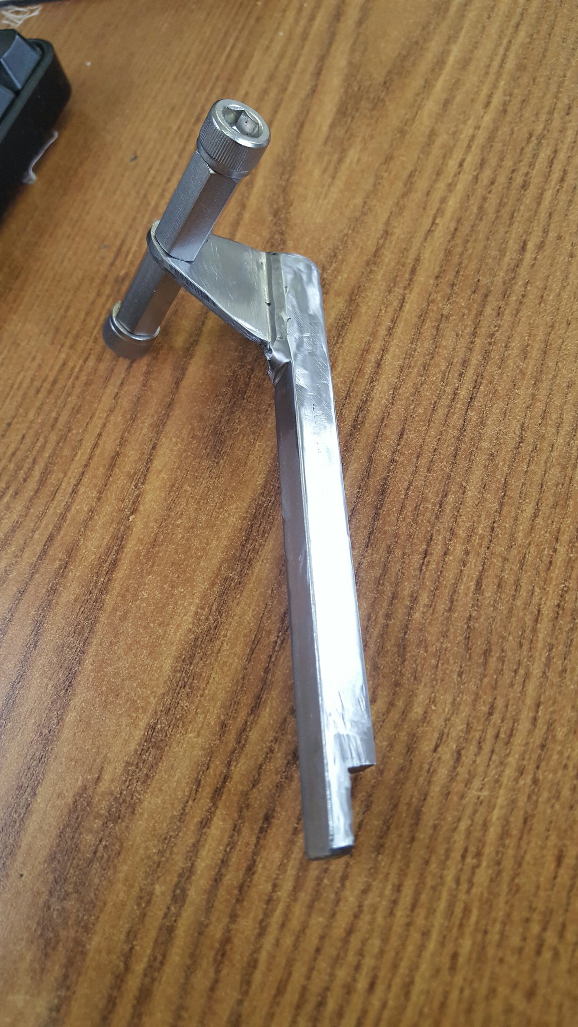

Spit and polish, making a bolt extension and adding a few finishing touches.
A poster suggested that I should copy a K31 so thanks to Corwin who stocks K31 knobs, I decided to change the charging knob to a factory model.
