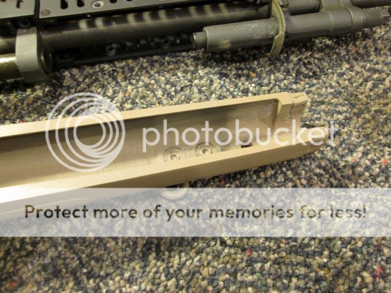

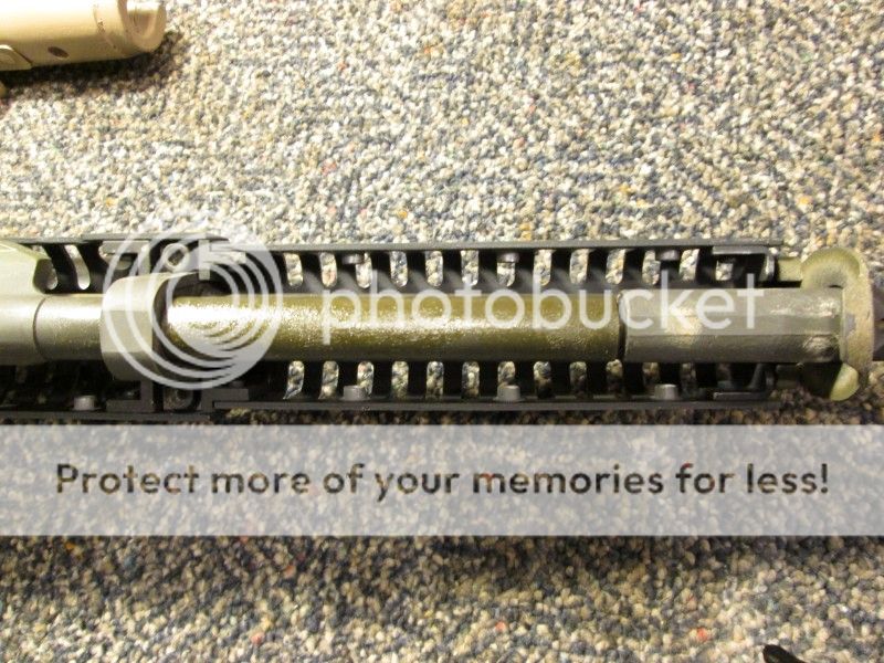

So, what has been your experience with the Vltor CASV-14 handguard rail for the M14/M1A/M305?
After installing the handguard on my Norinco, the accuracy became terrible. Lucky to get 8" patterns at 100m. I found that the handguard was in contact with the stock pretty much continuously from the op-rod guide to the stock cap on both my USGI and Vltor stocks.
I had to remove material from the stock and stock cap to get the proper gap. I did this on my USGI stock as a test before I go at my Vltor. I've only had a chance to shoot to 50m since modding the stock, but I was getting well shaped 1 1/2 -2 " 5 round groups at 50m with Norinco ball.
You can see the paint marks on the handguard from contact with the stock:
USGI stock after sanding and grinding on the end cap. I repainted the sanded area to make it easier to see contact with the handguard. It looks good after testing.
Vltor mod stock and CASV-14 for those unfamiliar:
