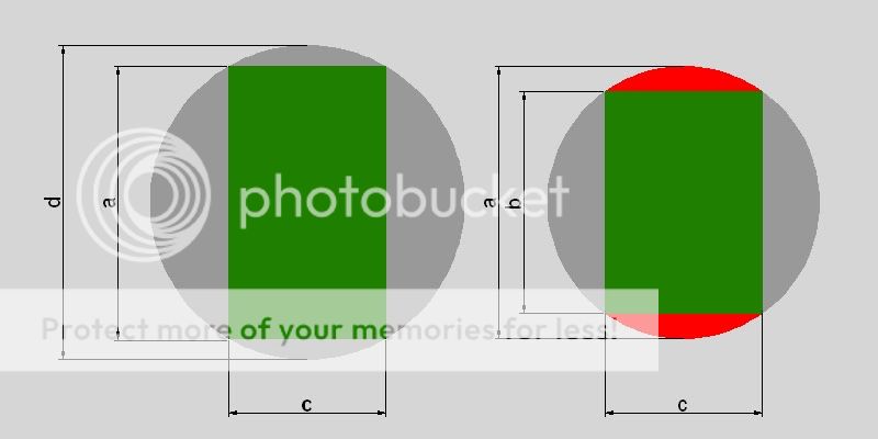

So my conversations on Sniper's Hide (here) have led me to believe that this issue with the turrets is 100% deisgn flaw. In order to get a scope that tracks a true box and has limited internals to avoid the PST's shortcomming, the only scopes I have heard will work are the S&B and Premiers.
Despite my dishearting and honest ad, my PST sold. Depending on how much I like the Falcon I have coming my way, I may or may not get another PST. If I do, I will be sure to map out the turrets actual abilities and I urge you to do the same, regardless of brand name (then share the results here!).
If you're looking for a scope that can track as advertised in the $1000 price range, I'd suggest looking into the Sightron SIII series; I have heard great things about them from Jerry at Mystic Precision and when I had mine I did not run into any problems.
When I get the chance I'll make posts about different brand name's turrets capabilities and we can slowly disambiguate which brand has legit turrets and which brands need special attention.
I hope this helps some people having similar issues!
Below is a great example of a scope tracking map similar to a Premier scope (Left). As you can see, they limit the amount of elevation so you can always use all the advertised windage and not run into the problems I have with my Vortex. The scope on the right is an example of the Vortex design; you are not limited to the elevation, but at max elevation, windage adjustment is restricted:

There is a large post in the precision forum on exactly this - how scopes from various companies actually function in the real world. You might consider aiding your thoughts there too.
The issue of limited windage for enhanced elevation is not unique and has been offered by various companies over the years.
The big difference is these companies disclose the range of functions. Most of these products also came with some form of multi point reticle making it less necessary to dial for windage.
Regardless of the brand, you need to test to prove to yourself what you have on your rifle and how it will work for you.

Just ran a quick test on my PST 6-24x50 FFP MOA this evening.
I attached my magnetic bore sighter that uses a grid image with 18MOA grid squares. The PST tracks and returns to zero flawlessly, and each click is exactly 0.25MOA, as advertised. With the windage mechanically zero'd, there is 69MOA of usable elevation- more than the 65MOA advertised. My rifle is zero'd with the windage 5.75MOA right of center, and at that setting, I have 68MOA of usable elevation. With the windage set to the extreme right side of its range, there was only 22MOA of elevation travel.

Was that 22 MoA of internal travel with the external turret still able to rotate or did the external turret seize and stop turning?
Internal travel. The turret still rotates, but the reticle stops moving, or else starts traveling in an arc, following the circumference of the scope tube that the erector is rubbing along.
This is exactly what I was told was normal by the Vortex techs and is also what turned me away from the product. Now I have my SWFA SS HD and will not be switching it out for anything else.
