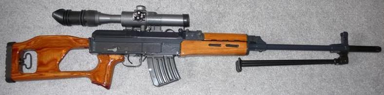

By contrast, others love the slant design. A great developer of 58 parts is Dlask Arms. They have compensators, brakes, flash eliminators, CAR stock adaptors and extended magazine releases.

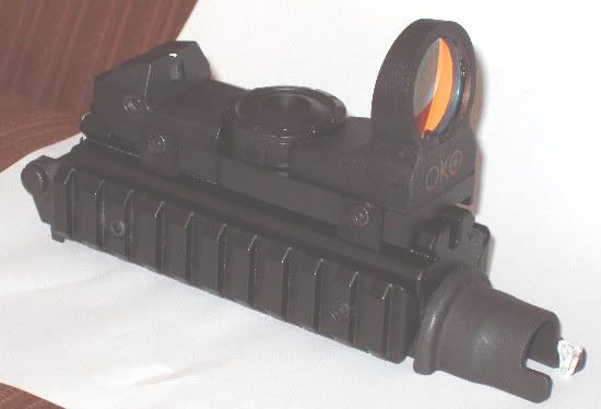

I need Red Dot sighting options. What’s out there? What kind of rails support these sights?
http://www.oktarget.cz/
http://i17.photobucket.com/albums/b87/telefonino/mount and OKO/fotkyms003-male-l.jpg
http://www.marstar.ca/ac-optics/images/SC-SKS1B-450px.jpg
http://www.wolverinesupplies.com/default.asp?Pg=8&do=3&mcid=1&scid=12&pid=142
http://www.armoria.fi/uploaded/punapiste.JPG?PHPSESSID=bdbe42e5f90440e24099cacd12cf21c7
B&T makes a crazy expensive one too.
B.C. Tactical's rail is impressive. It has Deck's vote.

Scope Mounting
Some people side mounted to get a scope.
http://www.kalinkaoptics.com/
http://www.posp.ru/
Or get a long eye relief scope for
http://www.scoutscopes.com/ which is sold through Marstar.
NEA is an innovative Canadian company. Deckard's vote is with this company.

7. pic of the scout mount on the rifle.
8. should you want to remove the scout mount and reinstall the ladder then the procedure are reverse .
helpful hints. you may want to scrape the paint off where the screws are in contact with the rear sight block, as for you would want a metal to metal contact and not have paint in between, also its a good idea to secure the screws with loctite , once you are zeroed in.[/QUOTE]
But, if you use that mount, it makes it a pain to clean it rifle. Is there a simple mod to keep the mount on? ESQ Scout Mod:
