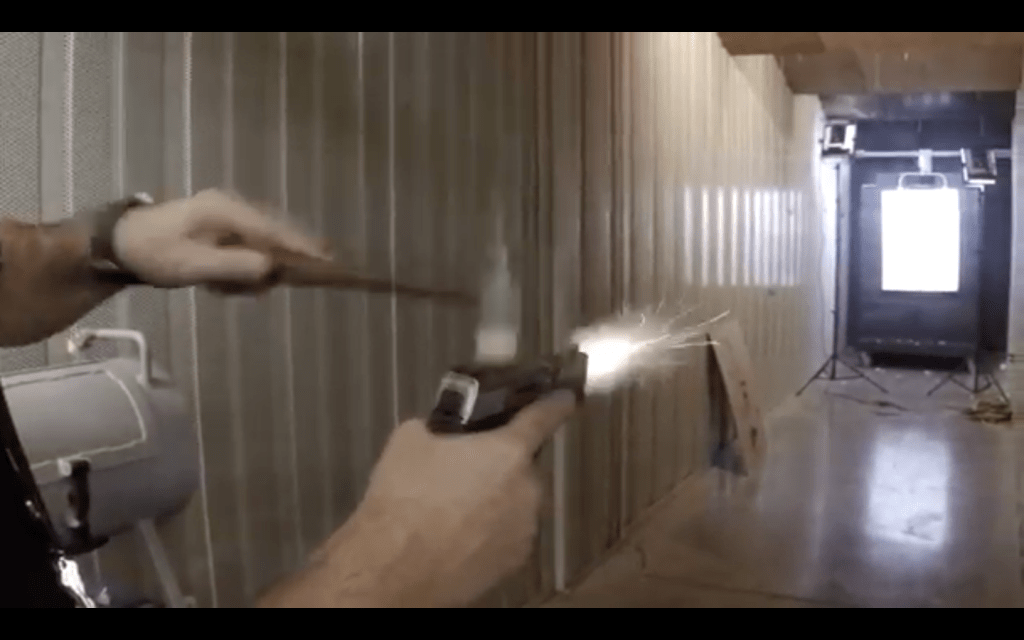

A screenshot from a DPS safety bulletin video showing how hitting an FNS pistol that is out of battery can result in it firing without pulling the trigger

During testing of the weapons in 2018, DPS found that three Fabrique Nationale pistols – the FNS 9 Longslide, which was carried by troopers, and the FNS C and FNS 9 – all had two conditions that could cause them to either fire without pulling the trigger or not fire when the trigger was pulled.
It is unknown what prompted the additional testing some three years after DPS began arming troopers with the FNS pistols.
In a safety bulletin video released internally in August 2018 and obtained by the Arizona Mirror through a public records request, footage is shown of the weapons firing after being bumped or hit.
“A tap, rack, any side-to-side or up-and-down movement, a sharp jarring blow and even holstering and unholstering will cause the weapon to fire with no further contact with the trigger,” a narrator in the undated video says after explaining the conditions in which this malfunction can occur.
The malfunction happens when the slide of the gun is slightly pushed back and the trigger and action does not fully reset. This is called being “out of battery.”
When a pistol is out of battery, safety mechanisms initiate to ensure the gun does not fire. However, DPS found that, in some instances when the slide was put back into position, the FN pistols would fire.
DPS also discovered that sometimes the gun wouldn’t fire when the slide returned to its normal position – but if the weapon was bumped or hit, it would fire unexpectedly.
