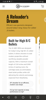

By slightly shortening and modifying our proven 6.5 and 338 RPM case, we optimized the overall length for high BC, heavy for caliber bullets.
