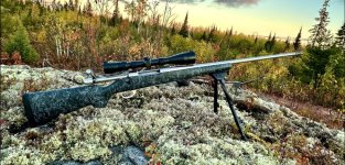

The VG2 in 300Wby I had shot factory 200gr ELDX at MOA. I never did try the pet loads provided, but the orig owner was getting sub-MOA with them.
It had some upgrades.. 24” length, Trigger Tech, bedded into a B&C Stock. Whether any of those helped or not who knows. It weighed in at 8.2lbs with a Bushy 4200 2.5-10x40mm atop. Just about the perfect weight range for a Mag Cal (8.5lbs) IMO
The only nit-picky thing I didn’t like about the rifle was the concussive blast from the radial brake. Recoil was VERY tolerable with it though, say stout 270- mid 30-06’ish range. That and factory ammo wasn’t cheap (then again nothing is these days).
