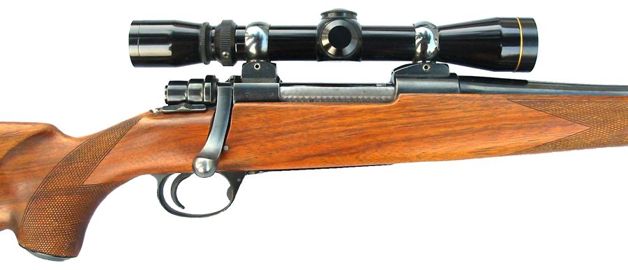

That's about all I can contribute to the discussion... other than to circle back to the initial post with a bolt reshape job Bill did on a couple of my Huskys because I found the blued Mannlicher look much more pleasing to the eye than the stock silvery round ball bolt the rifle came with. How Bill converted the original stem and ball bolt to the Mannlicher style, I can't recall:
Chuck,
Seek a craftsman who is proficient at engraving &/or checkering bolt knobs,if you decide to use the existing handle.
Is your swing safety cocking the firing pin (2nd pic) & disconnecting the trigger per design.
(can't tell by pic)
Appears handle at sweep touches the stock inlet-not good per an accuracy standpoint.
(handle touches the receiver on the underside of handle boss...only)
Handle cross section seems compromised to clear scope ocular lens w/ low rings.

The swing safety is in the fire position and the rifle is cocked in that picture. The bolt handle is not touching the stock. But there isn’t wild gaps either. The bolt handle will clear a scope in low rings and will super low rings as well. Steve Heilman did the bolt work. Here is the finished rifle.
