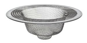

You could use this in the sink drain.
I had a new laundry sick installed in my garage just for doing this. The trap has a drain on the bottom of it that a Lee Valley rare earth magnet fits into perfectly. Catches all the pins that decide to go crazy. But it seems no matter what I do, there is always a pin or 3 that manages to go ballistic and take off, that I find says later meters away from where I am cleaning the brass.
