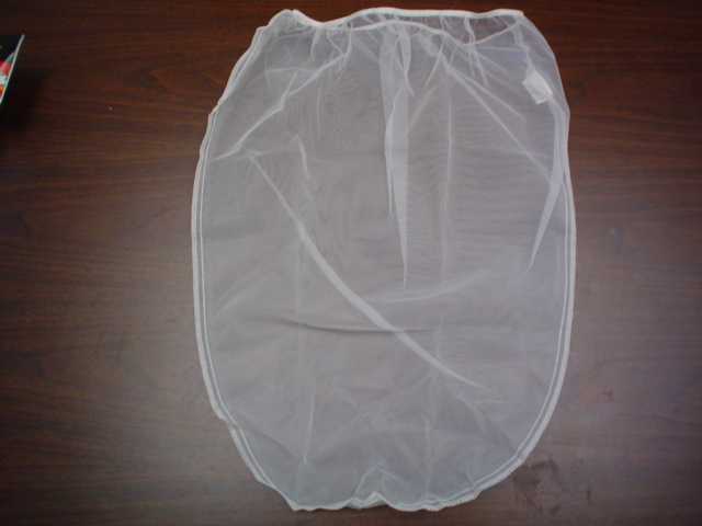

After I'm done tumbling, I just pour it all through a paint strainer to get rid of the water.
Something like this:
It catches all the casings and the SS Media and lets the liquids drain out freely. The 59 cent solution.
That is a great idea, thanks for the tip.
