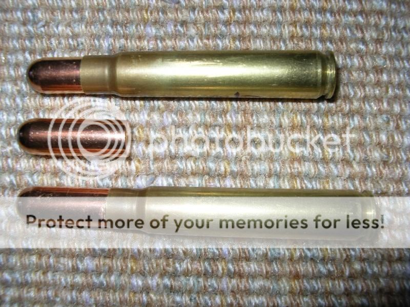

This 285 gr 0 ogive bullet must be seated very deep in my custom pre-64 chambered in 9.3X62 (top in picture), but chambers just fine seated way out in one of my Husqvarnas (bottom). It should do great in BUMs rifle.

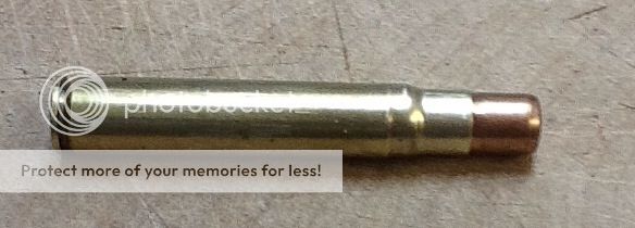

This photo illustrates a fairly deep freebore in another 9.3X62. It was shown clearly by partially seating a bullet, upside down, and allowing the bolt to finish seating as it came into contact with the beginning of the rifling in the chamber. There is almost 1 1/4 caliber of throat before the rifling begins. The long-throated Husqvarna from the picture above has more than two calibers of freebore!

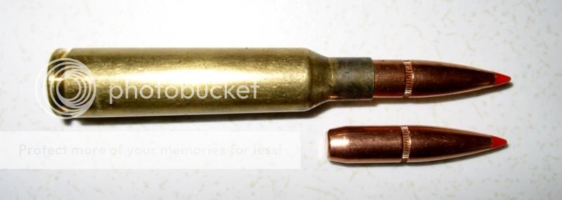

In addition I found with the maximum possible reliable length of my magazine, 3.400" would be the longest length I could handle. Using the 285gr Prvi bullets I picked up at a recent show in Duncan I made up a dummy round with just enough interference on the neck to hold the bullet. Chambering it, the C.O.A.L. came out at 3.418" when it contacted the lands. Doing the same with a 286gr Barnes TSX FB that I picked up at the 'candy store' in Naniamo, the C.O.A.L. hitting the lands was 3.453". Anyway, bottem line, my max could be 3.400" or less. With the 285gr Prvi, I decided on or went with a max of 3.323" as I didn't like how little of bullet was being held by the neck but also at this length, I could put a light roll crimp on the bottem groove of the bullet. 1st trip to the range with some initial test rounds, then my 1st batch of reloads, I was pleasantly suprised and I've posted these results on another thread.
In the majority of cases with other rifle calibres I reload for, generally speaking, my best accuracy results are when I've minimized the freebore to 0.005" - 0.010". In my .366 Wagner, I'm about 0.077" off of the lands with the 285gr Prvi. I haven't reloaded any of the 286gr TSX Barnes yet but in their manual, the 'suggest' a maximum C.O.A.L. of 3.205". In my rifle, with the Barnes contacting the lands at 3.453" and their max 'suggestion' of 3.205" that would give me a freebore of 0.248"!! Yikes! Even with my possible max of 3.400", that's still a freebore of 0.053"! This 'seems' to go against everything I've found to work well for me in past but I can't agrue with the results I've got so far.
