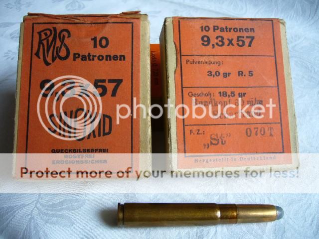

I have noticed this as well, especially in European calibers/rifles, for years. But I think we have to bear in mind, at least for the Husqvarnas, that the rifles / barrels are all at least a half century old & for the 9.3x57's, at least 75 years old, so I would presume there is a fair bit of throat / leade wear to factor into the equation as well. I can seat spitzer bullets out almost 0.050" longer in one of my Husqvarna Model 46's 6.5x55's compared to one of the new Husqvarna barrels.
Ted:
Do you think this all boils down to the amount of throat wear in existence on our 9.3mm rifles, especially given that 99.9% of the 9.3x57's (almost all of which are now at least 3/4 of a century young) & likely some amount North of 60% of the 9.3x62's made came out of 1 factory?
Your new iron having had a different (non-worn, non-Husqvarna) reamer through it, I beleive, supports this hypothesis.
Regardless, all of the .366's are FUN!!!!!
