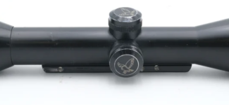

Ever seen a scope that was actually bent to the naked eye? My point was that by adding a European style rail you increase the resistance of the scope tube to bend.
Now regarding levelling crosshairs, having that scope rail removes this step entirely. To set up a round tube I used those levels but needed more accuracy so I grabbed my magnetic based digital protractor to level the rifle’s action. Then using a plumb line set about 25 yards away I line up the reticle vertically by eye. There are many plumb edges looking out the window with houses, posts, fences etc. check one for true level and you’re all set. If it works for top shooters in F-Class it’s good enough for me.

Sure this Swarovski SR rail system removes the need of levelling, assuming they etched the scope reticle perfectly in the first place, however, if you plan on using an adapter, or a third party item in the middle its completely pointless. If you install the Scope to a properly installed Swarovski mount that is meant for the rifle, you wont have any issues, but if you buy an adapter to run this scope on a picatinny rail bases mounted to your receiver, that adds unwanted tolerance stacking, and if not everything was made perfectly level, your scope wont be either, which defeats the purpose and now has no adjustability. IF it was so perfect, why did Swarovski themselves discontinue the use for it and switch to round tubes and rings for their scopes?
Using scope rings allows you to position it in any manner and distance. You generally level your action/rail rings. (regardless of how your stock is), and now you level your scope with a plumb line, this just guarantees your scope etching will be perfectly plumb to a perfectly leveled rifle this also guarantees a perfectly levelled reticle regardless of where and how the scope turrets are since the tolerance of reticle etching doesn't mater as the scope is levelled using the reticle and will match your bullet drop on a 'levelled rifle'.
