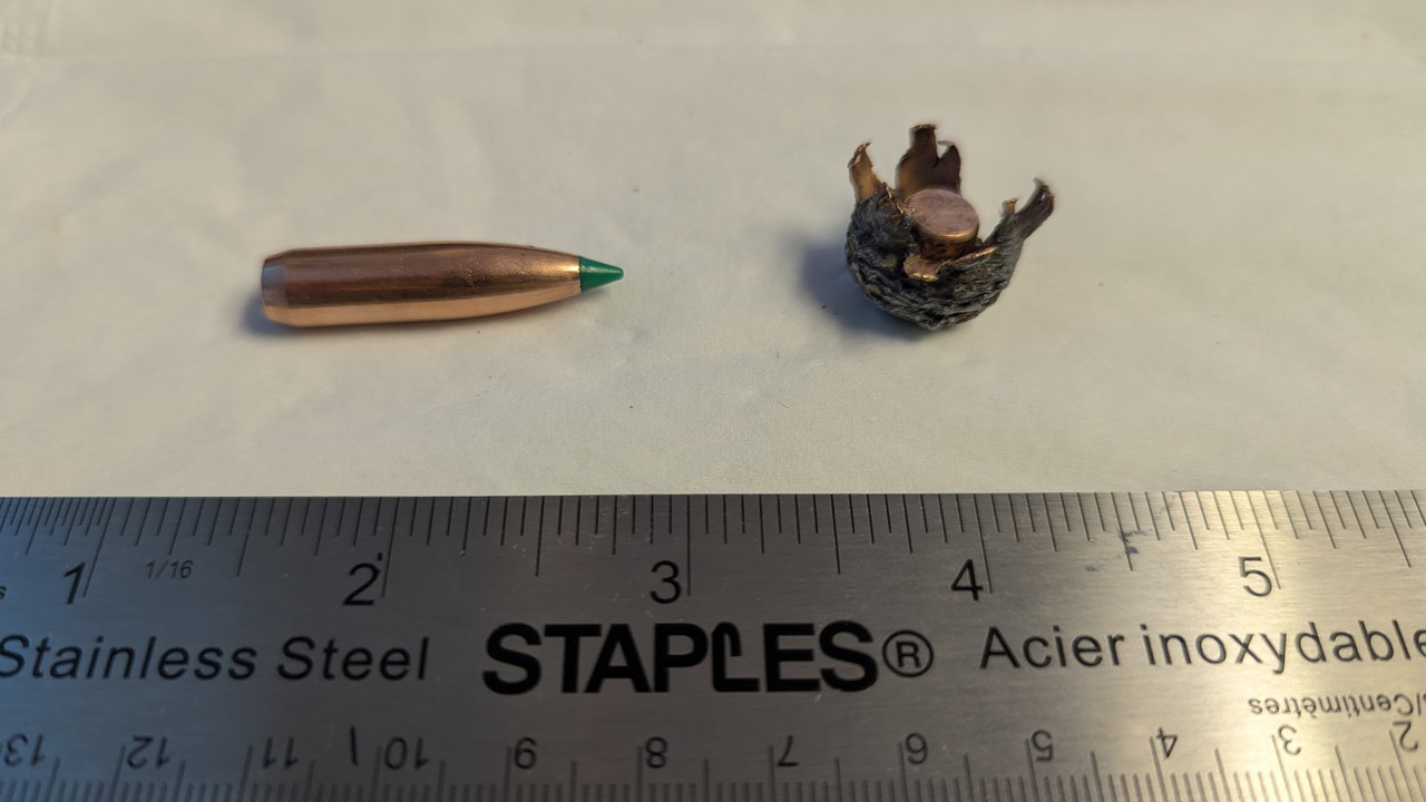

I had good success with Nosler's 180gr Ballistic Tip on a moose this year. The recovered bullet mushroomed perfectly and had retained more than 90% of its mass. It has also proved to be a sub-MOA shooter in my rifle at the range.
Curious to the range? That’s a high % retained for a NBT.
So just about all the bullets on the market from the major manufacturers was recommended, because they worked for them. My conclusion is it doesn't matter, vanilla, chocolate or strawberry. I recommend doing the math, find one in your price range that gives you the trajectory and energy your looking for and go. After all it's 100% shot placement 0% talk.

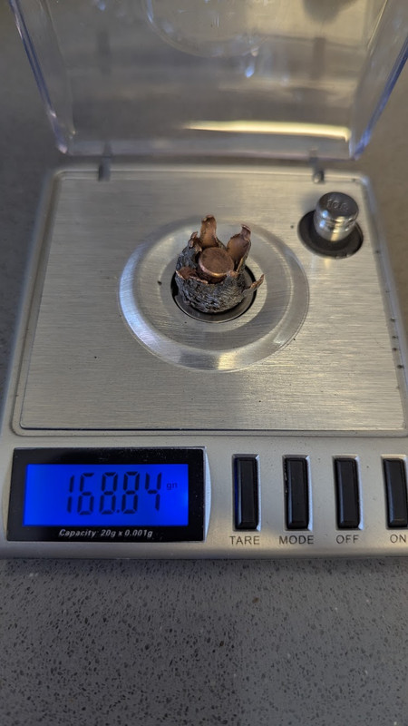

Lased at 254 yds. According to my ballistic calcs (based on MV from chrony), the round should have been still going ~2087fps at 250yds.
I have a picture of it on the scale at 168.84gr, which (unless I biffed the math) is around 93% retention. I was quite surprised too.
Please educate me if any of this looks wrong. This is the first hunting round I've been able to recover.
Cheers,
Sam
