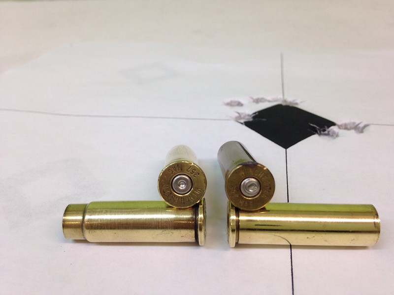

Ok range report, Put 25 rounds through it on the weekend, a very preliminary testing for function.
we were only at 25 yards and as expected, the sights were way low (about 5").
I was VERY pleased with cycling! I'd put a small radius on the mouth of the chamber to act as a feed ramp to prevent the case mouth from hanging up, and low and behold, my rounds fed just fine! The ejector functioned nice and positively and the goups(shot standing) seemed pretty reasonable.
These were all low pressure, .357mag length loads with 110gr bullets.
The spent brass looks pretty good and the primer strikes are WAAAY nicer than with the old bolt/pin
More testing required...
primer strikes are great now ,no flow .Target from testing for function are just that as you got the lil rifle functioning ,and the next target will be for effect LOL
all in great job ,

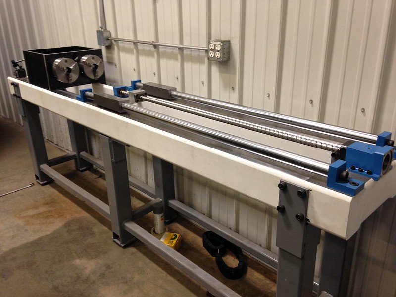

I havent been idle, although there isnt much to look at at the moment.
Ive temporarily set aside my guilty pleasure of the lever project to focus on the final push to finigh my rifling machine.
Ive been working with my electrician wiring things up. we bench tested the system last week and Im hoping to get everything mounted this week. With some luck I hope to motion test the machine in the next couple of weeks!

I'm still working out the electrcal end of things but in the mean time I DID get the chuck box finished up.
Its mostly looking like a machine.... taunting me.... reminding me that shooting season is dangerously close....

But I DID manage to get my machine wired up and motion tested. The user interface designed, and the programming figured out!
I need to get the oil pump system sorted out and make tooling. I'm hoping to make cutter boxes this weekend...

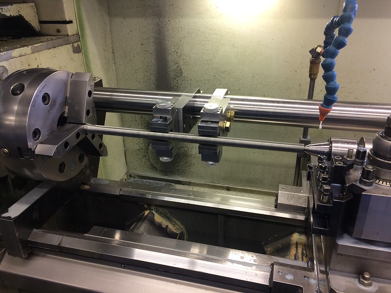

Another, related project I've recently completed is to build a "steady" that will allow me to support long skinny work pieces such as this 1" NC thread I turned down and cut @ 24" long.
(should be very handy for contouring barrels)

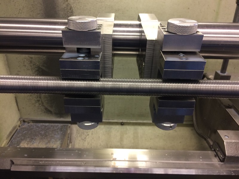

Basically, Its a heavy wall tube(loaded with sand) that mounts to the machine ways behind the chuck and between the carriage and tailstock.
It has two "vices" each with independent jaws. The jaws have replaceable "pads" that support the work piece and the cutting tool can cut right on by.
As the tool passes by the first vice, thereby reducing the part diameter, the jaws are adjusted to compensate. By having two vices next to each other, the work piece is never unsupported.
Seems to work pretty slick!
