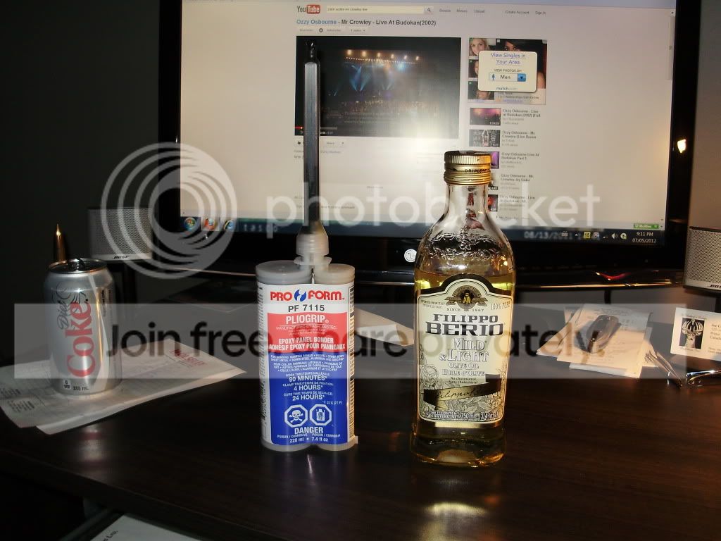

What you see is what I am now using for bedding compound and release agent.
Kelly, lol, is that diet coke undiluted? On a serious note, Is that olive oil?? can't really make it out in the photo.

That is 100% pure rebel bad ass diet coke!!!
Yes, it is olive oil, doesn't leave any odd colored release agent on the action and cleans up easily and even if you don't get it all it won't bother a thing.

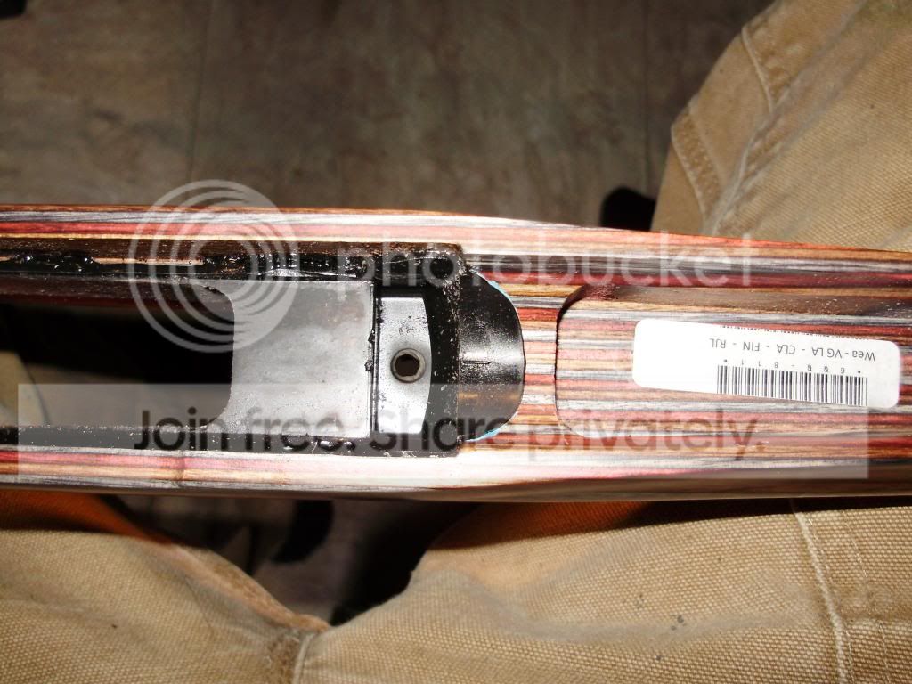

That is the bedded recoil lug of a Vanguard into a Boyd's stock, that is right after removal of the action, prior to trimming and cleaning.So as you can see it releases fairly clean.
