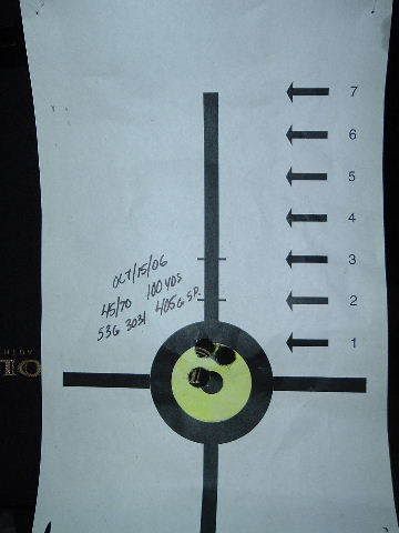

Micro-groove rifling in a 1978 no cross bolt safety.Didn't like IMR 3031 for the 350gr .Wearing a 4x Leupold and I still got both eyebrows! Harold

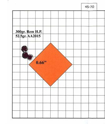

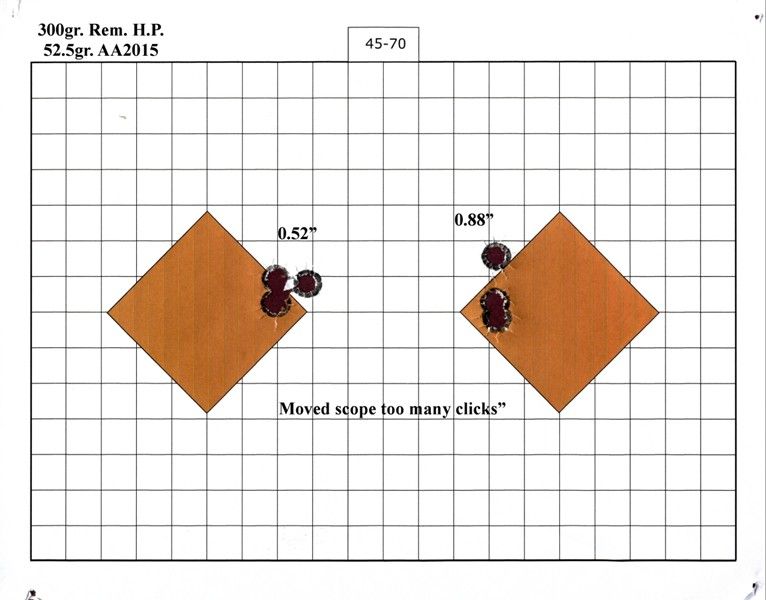

Looking at the bullet you've listed on your target as being used for your results, rang a little bell.
In my jacketed bullet storage shelves, tucked behind the 45 cal bullets on the bottem right, I found a bag of 100, Remington 300gr SJHP bullets. I had totally forgotten all about them 'til I saw what you had listed on your target. I'll have to give them a try.
