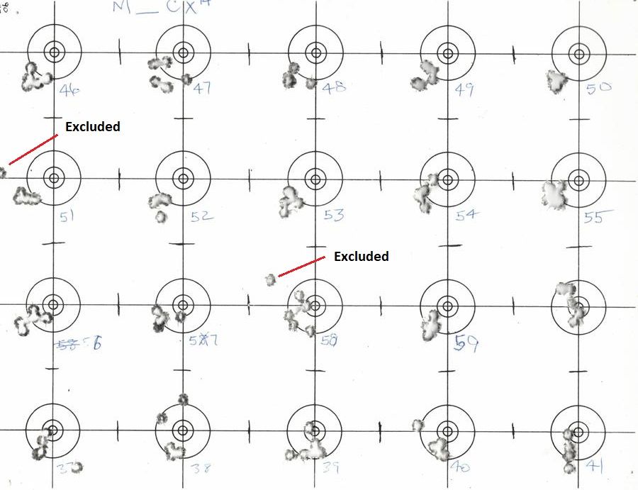

First image is 5 shot groups at consecutive tuner positions. I have already shot the lowest 100 positions by two. Hi-graded and passed on anything in the first 50 and now this is the hi-grade for the next 50. 46-59 contain a good tune, 37-42 a stopped low position, likely 40.
51 and 58 are 6 round groups, both contain a high left impact. It is worth noting that in shooting this lot without a tuner it has thrown 4 and 0 outright fliers in 40 round sessions. Settings 46 to 59 represent 70 rounds and I'm claiming two mulligans in my testing today.

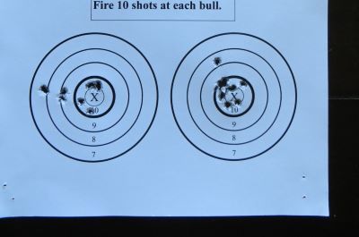

At this point I haven't shot this lot enough to really know what it will do, either with or without a tuner. The target you turned right side up is promising in that there is a wide range of consistent grouping with a relatively stable and rising POI but not super tight. This is really a demonstration of my method and observations rather a definitive quantification of the effect of a tuner on this lot of ammo.

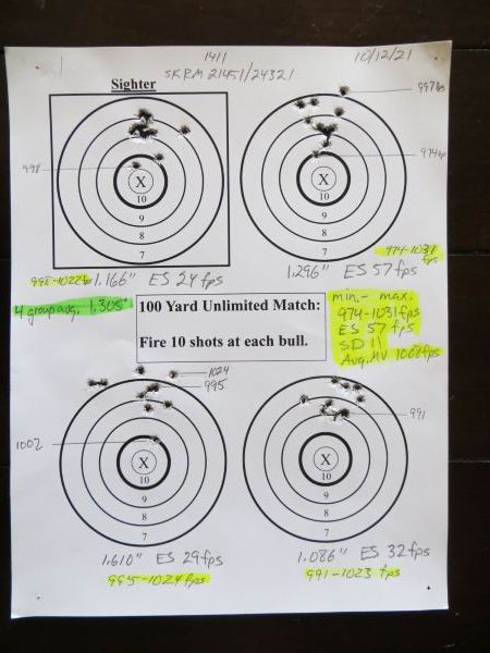

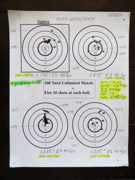

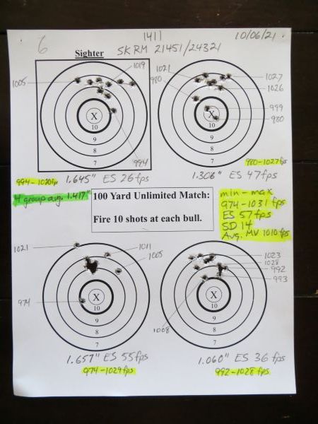

It's not always the ammo's fault. I remember seeing ES of almost 100 fps out of target ammo(brand escapes me at the moment). Switching rifles, the same box started showing 15 fps ES.Over the chrony several boxes of one lot of Center X showed it had an ES over 80 fps, with SD figures in the high teens. That kind of CX shouldn't exist let alone be sold. It was the poorest shooting lot of Lapua I've encounterd. By comparison, the most consistent lot of CX I've used had ES figures in the high 20's with an SD figure of 6 fps. It performed well on target. I tested a lot of X-Act that had an ES over 50 fps with an SD as high as high as 11 over a box. That lot of X-Act shouldn't exist either.

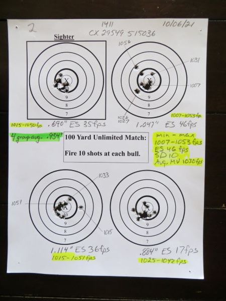

Before I go fishing I have a question for you. If you chrony or know shooters that do, what is the relationship between what a calculator would predict and what you observe on target?
... two fish later
That looks like a stupid question to me. I expect your calculator lines up sufficiently with your target to get you hits. What I'm really wondering is how consistently slower rounds are actually low and vice- versa. To build this incrementally lets start at 100 yards. What is a typical group size?
