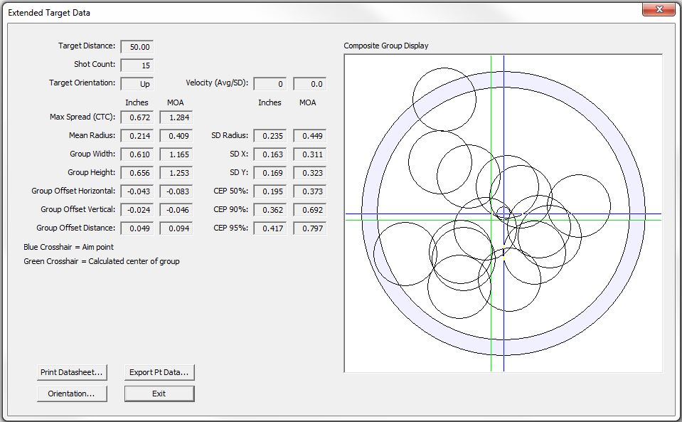

I am not a stats guy, and I just mess around with stats. (For serious work I would hire a stats professional). On first glance at the resulting means (averages) of your replicates of your 5-shot groups for tuner settings 1,6,8,10, I suspected that these means might not be statistically "significantly different", i.e. the range of means from 0.47 to 0.60, given the size of the ES and SD's (see augmented table below) indicates that there is alot of overlap of distributions.

Table 1 below is the copied data for the 5-shot group replicates for tuner settings 1,6,8,10, with added ES, SD and Variance:

When we look at tuner setting 10 we can see what looks like a much smaller ES and SD. The group mean of tuner setting 6 (0.47) is smaller than tuner setting 10 (0.52). But setting 10's ES is more than twice as small as setting 6's ES. Based on the ES, I would chose tuner setting 10 in a match. In a match for score, I would much rather have that small 0.27 ES working in my favour.
