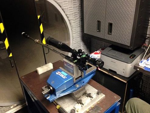

For readers unfamiliar with "clamping" a rifle or barreled action, it is similar to the way rifle makers and ammo manufacturers test their products. They literally have a vise or fixture into which a barreled action (or a rifle with it's stock) is clamped. They are shot in a windless testing tunnel. This is done to test either the rifle or the ammo with the shooter taken out of the equation.
Below is an example from the Lapua testing facility in Mesa, Arizona.

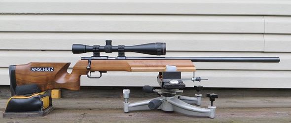

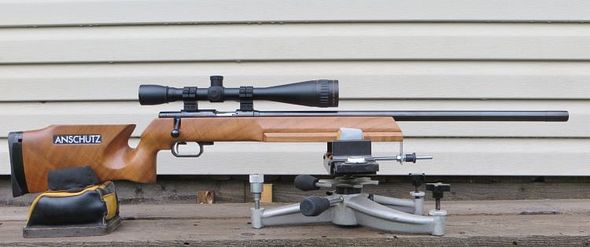

Another option is an Anschutz match barreled action coupled with an Anschutz BR 50 stock. The stock (two configurations available, one designed for free recoil, the other not) can take a brand new single shot barreled action or an older Match 54 single shot.
Below, for example, is a 1974-made Anschutz 1407 barreled action in an Anschutz BR 50 stock. Beneath it is a much newer Anschutz 1913 in a BR 50 stock.

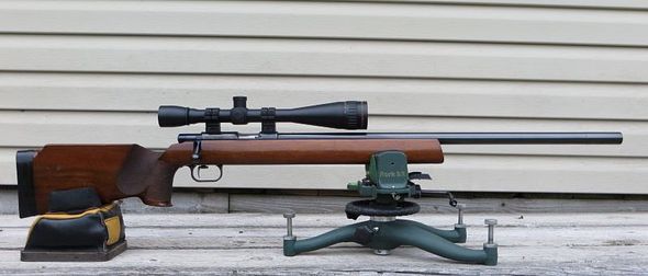

It should be noted that with the right rest, there are some models of unaltered original match rifles that are good for BR shooting, including Walther and Anschutz.
Below is a Walther UIT Spezial, this one probably from 1973 or 1974.

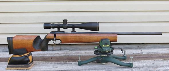

Below is an Anschutz 1411, a prone rifle which is very good from the bench because of it's more bench-friendly stock design. Below it is a picture of the same rifle with a BR 50 stock.

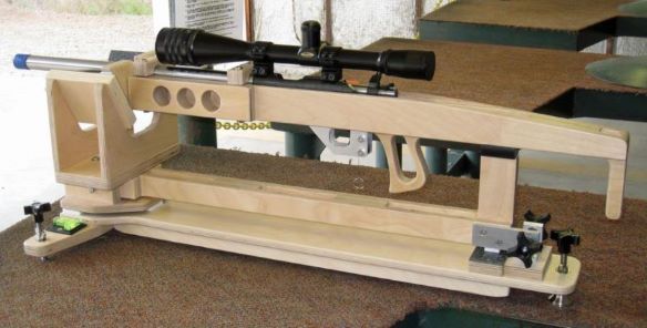

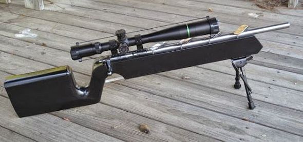

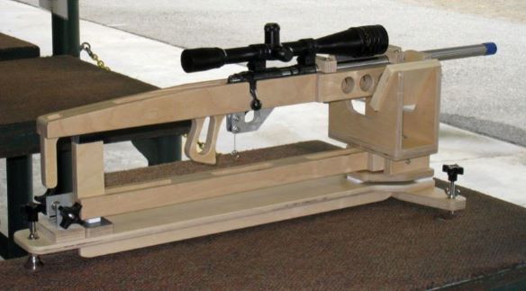

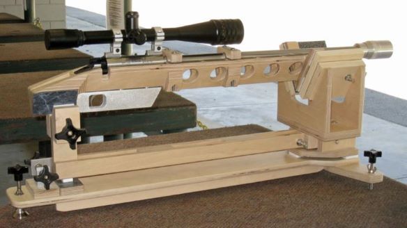

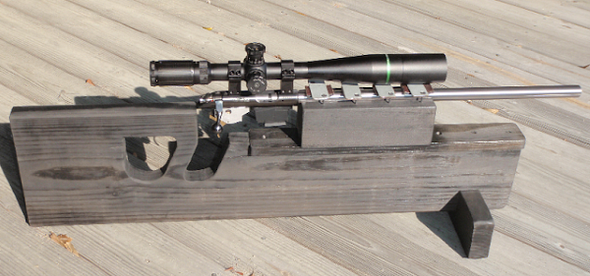

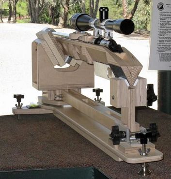

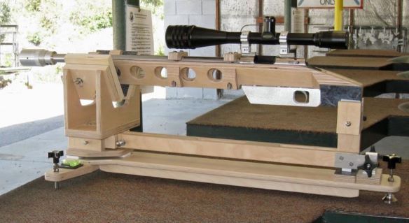

If you are handy with woodworking and woodworking tools, you can design and make a stock or "rig" for a barreled action.
Some can be relatively simple, such as the rig made for this CZ 455 action with a Lilja barrel.
Others can be a little more work as seen below with this CZ 455 with a Lilja barrel made by engineer Albert Highe.
Something similar can be done with a top-of-the-line 2500X barreled action, also made by Highe.
