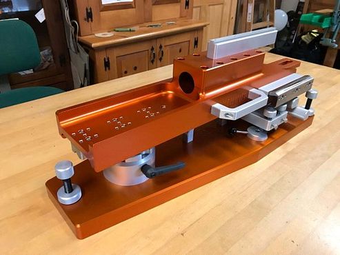

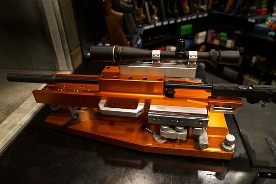

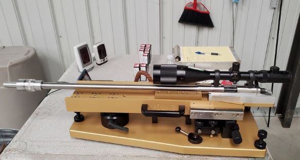

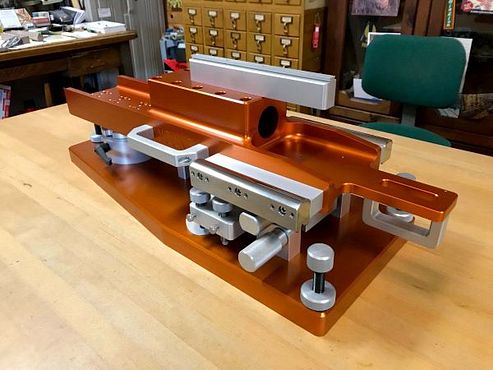

If something like a "rail gun" is the goal, it may be possible to manufacture or obtain something like the rig shown below.
It's worth noting that on the rig on the first the barrel is free floated, while on the next, the barrel is clamped. Both rigs are the same make.
Thank you Sir, these "rail guns" look fantastic, I am lurking these for several years. In my eyes the artistic image is just perfect, from engineering point these are very easy to make if we have access to materials and machines, the paint job on the other hand I would just outsource ;(

Is this orange rest your?
orange rest is a
young railgun with a anodized finish
made in the usa for a couple of decades and the design has not changed much
he made some SPLASH Color’s a couple years back that were stunning
