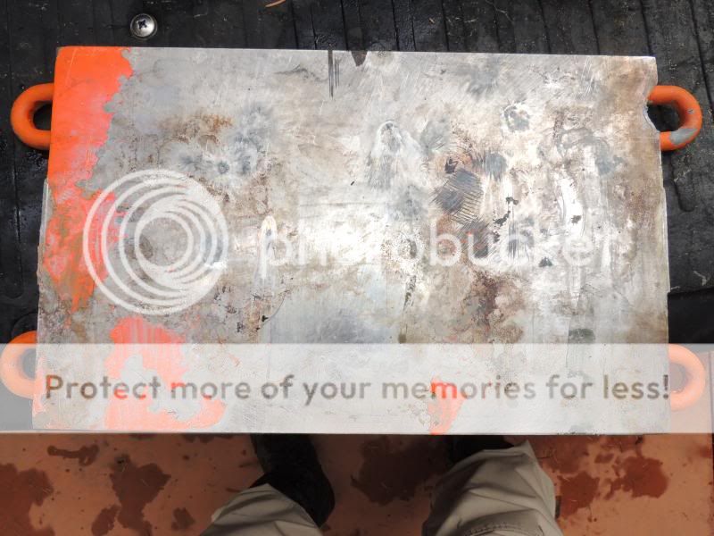

I've since switched to blind flanges and 1/2" plate steel 36"x24 with the use of paint.
