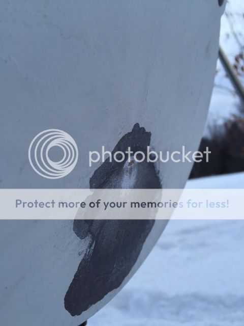

Yesterday I've tried my HARDOX500 target, a 8" gong 1/2 thick with my 30-06 at 15 feet... Not a signle recess or scratch!!! This steel is kinda hard! ;) But no really long range skills here hehe
Si I will do myself a 12" gong, I think that 3/8 thick with the same steel will be enough, right?Evil_Dark
You'd think so wouldn't you? We broke a 3/8" AR 500 IPSC silhouette at 800 yards the other day. A couple too many headshots, a few too many 300 grain SMKs, a sharp corner for a crack to start and presto, a two piece target.:(
Haha your nuts! 30-06 at 5 yards!
Well, I wanted to test the steel resistance... A torture test ;)
I'm uste to 3/8 normal steel, and the 30-06 goes through without problems, like a drill. Was impressive to see that there were not a scratch at 15 feets!! The plate was inclined downward to send the debris on the ground.

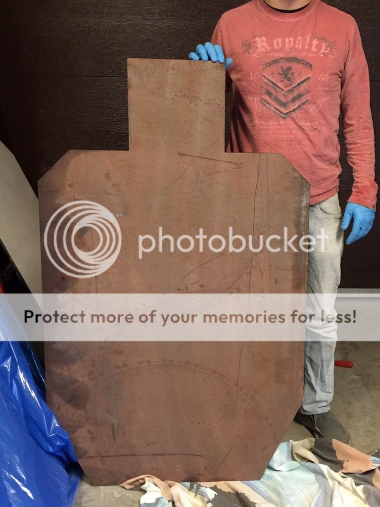

Ok, here's what I made for my loooong range shooting AR500 gong:
Haha :) Big enough ! But this thing is heavy as hell...

We'll, I've taken the advice of having a big plate to see where I hit to help adjust the next shot. I can put a small circle in the middle.
This target is the result of an error on the scaling of my CAD drawing conversion to DWG... After the cut was done, It was too late... So i'll keep it, the AR500 material is so expensive!

Plus, if push comes to shove, you could lop the head off and then cut the target in half at the waste=two torso sized gongs and a small square gong to set up at different distances..... No more material, just labour to cut.
