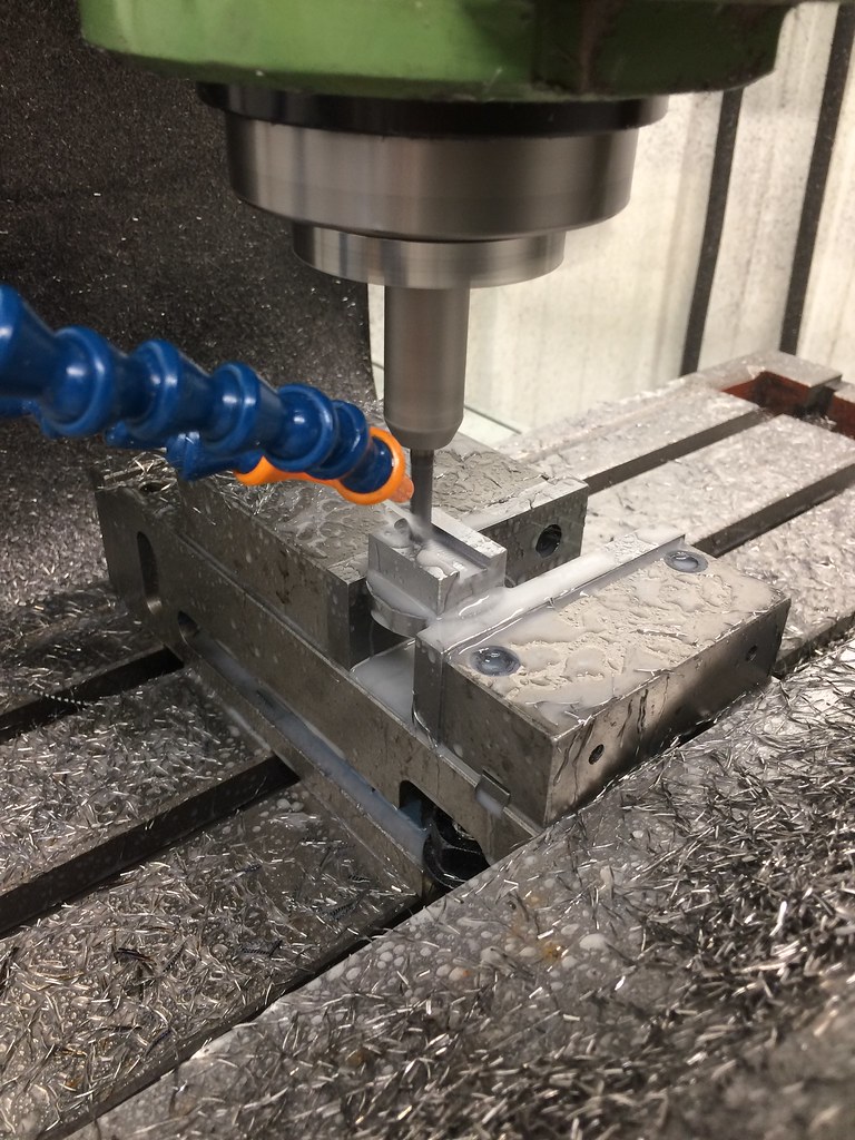

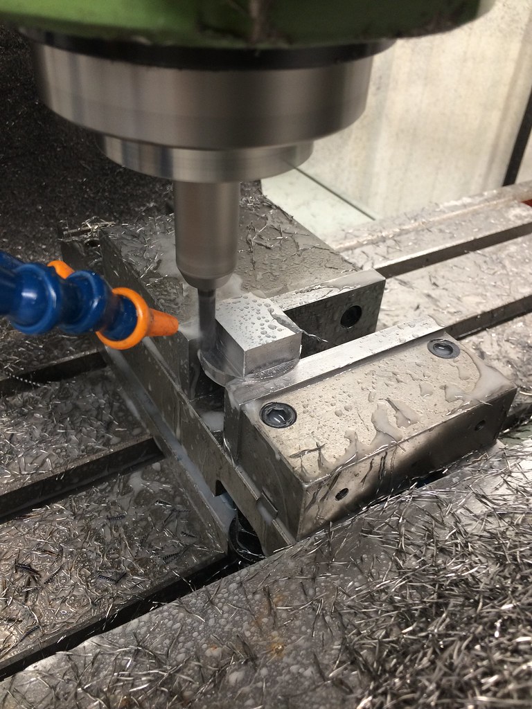

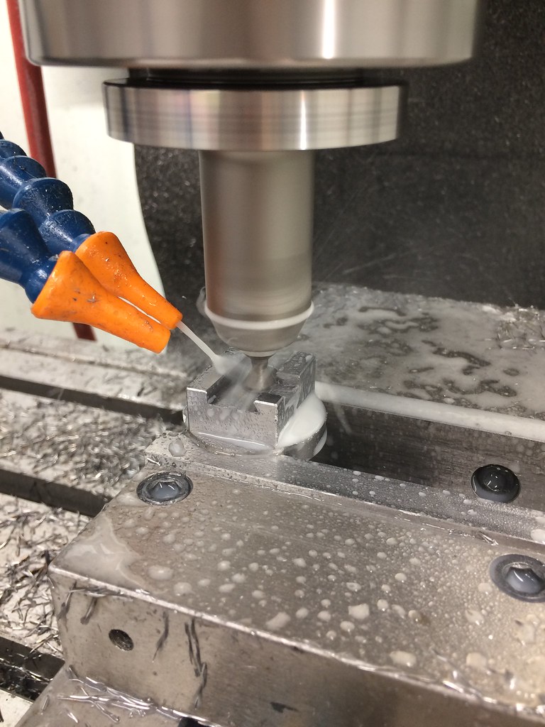

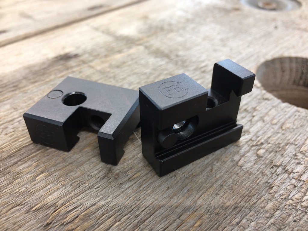

100y: These are for a long action , I believe the dovetail dimensions on yours will be different. You could send me your rifle and I can do whatever you like, or you could probably get away with sending me sample bases to go off of.
Sako mounts; making chips!

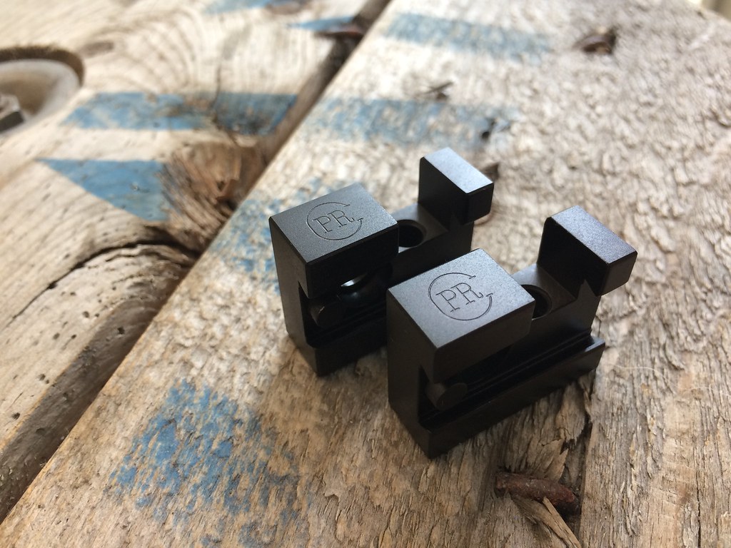

A 'Sako worthy' end result (if I do say so...)

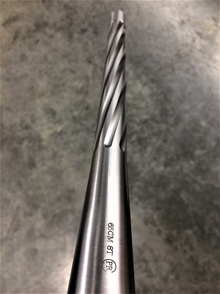

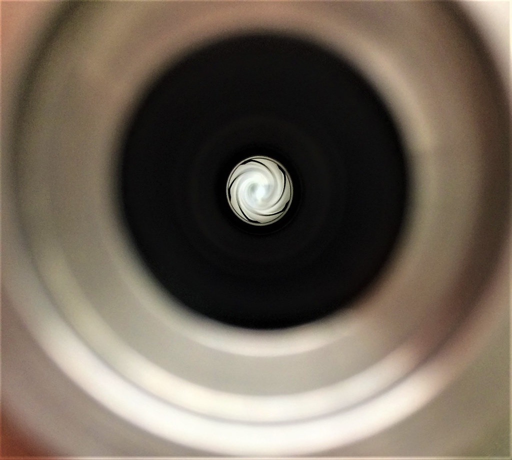

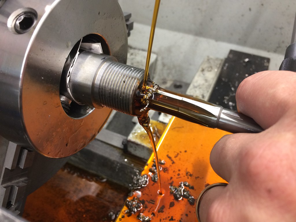

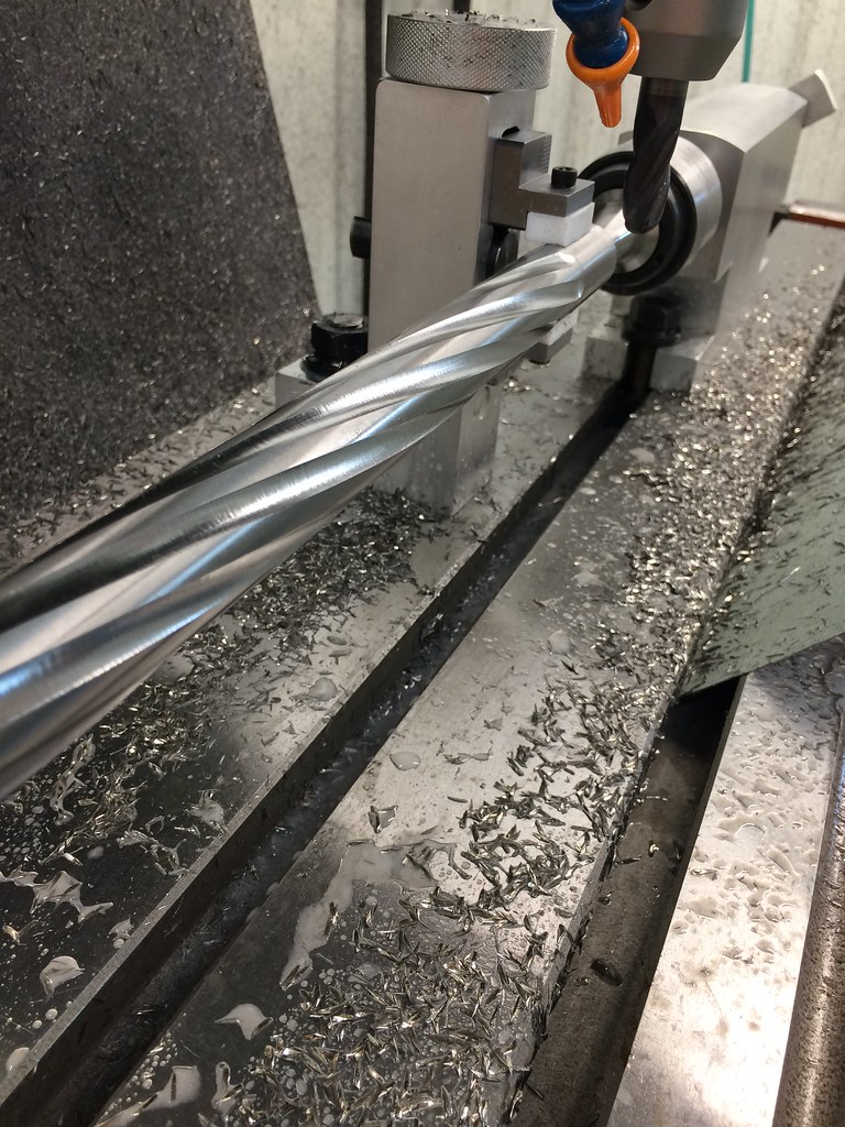

Also did a 6.5CM build on a Stiller Tac30 action this past week.
Along with some helical fluting to give it some class...

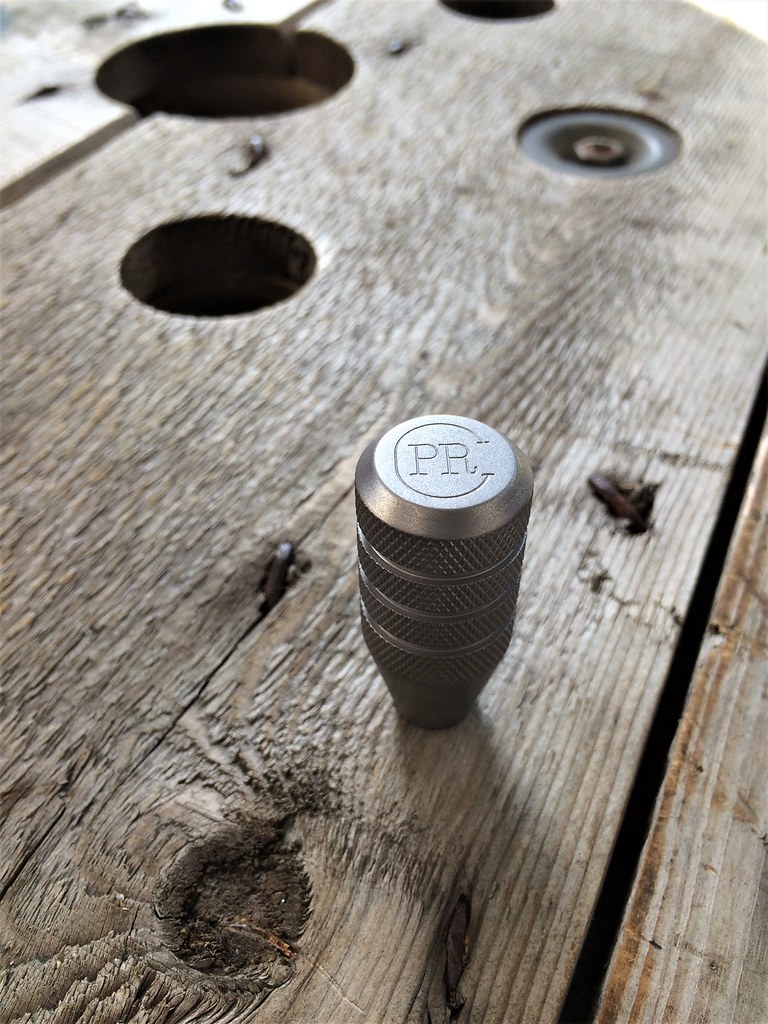

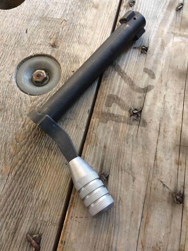

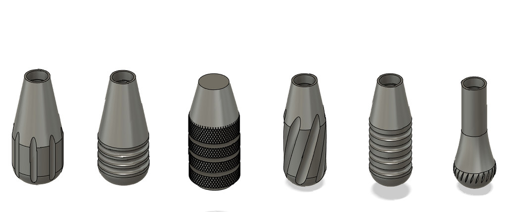

I had another busy week, among other things I built that bolt knob for mikeyb...
As always, the possibilities are endless, this one was a variation of the middle/left Cad sample here.

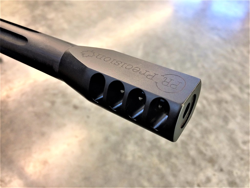

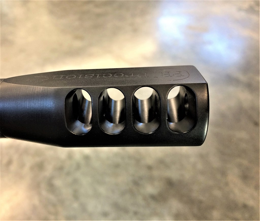

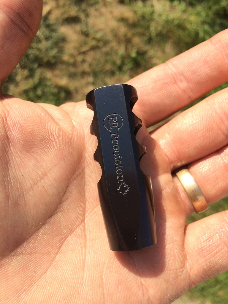

I also did a few brakes...
I love the look of a high gloss, blued finish in the sun light!

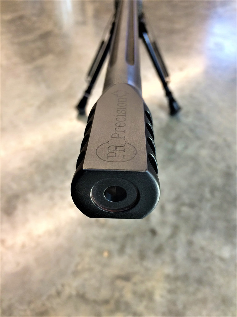

I also did this one... Most of the brakes I make are intended to be discrete, yet highly effective, intended for hunting weight rifles.
Every now and then however, I get a request for something "obnoxiously large"...
I'm calling this one the "V8"
With a fourth gill added, and the two sides angled into eachother to create a 30deg Vee; This bad sally should positively arrest both rearward recoil and muzzle rise!
While it would look rediculous on a sporter weight, the effect on a target platform is rather striking!

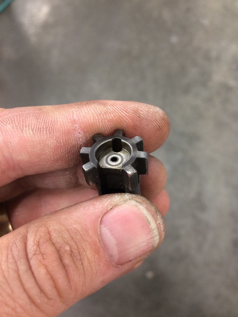

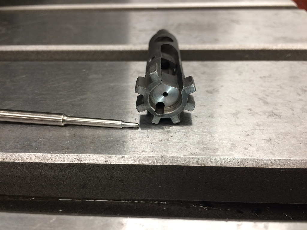

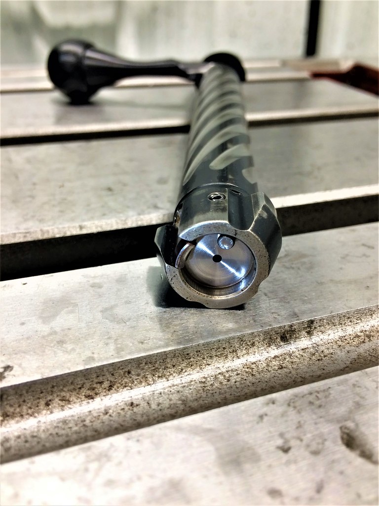

WK180 bolt bushing before...
And after.
I also bushed and fluted this Tikka bolt.

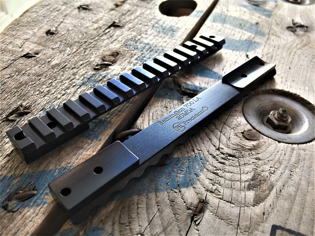

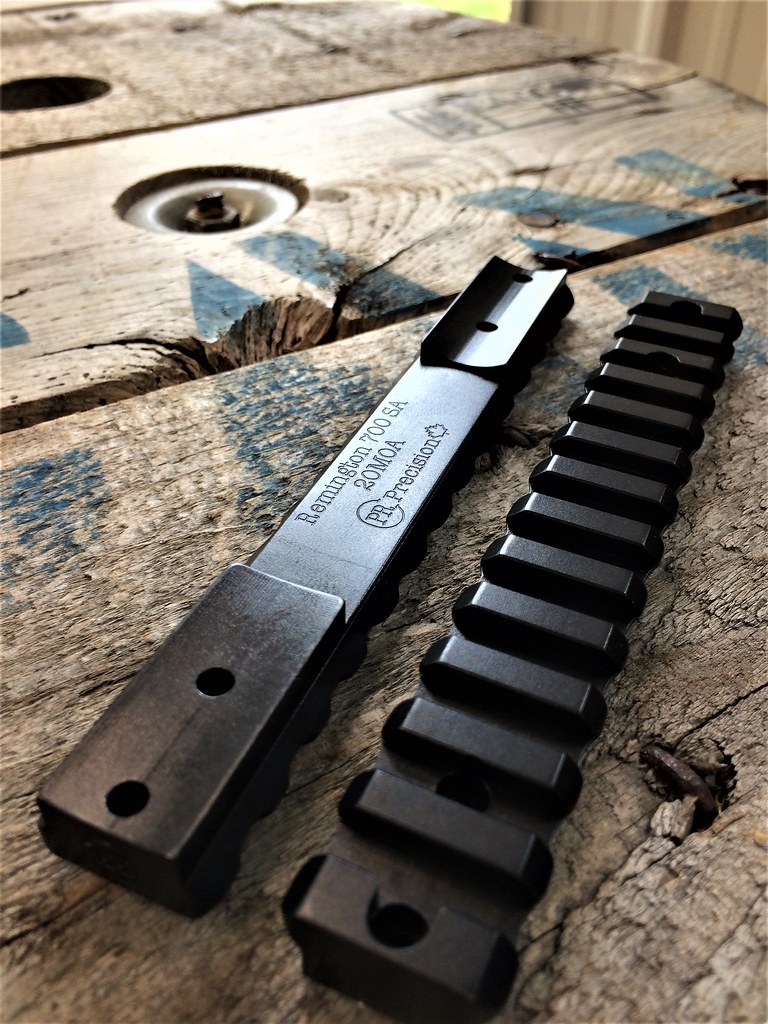

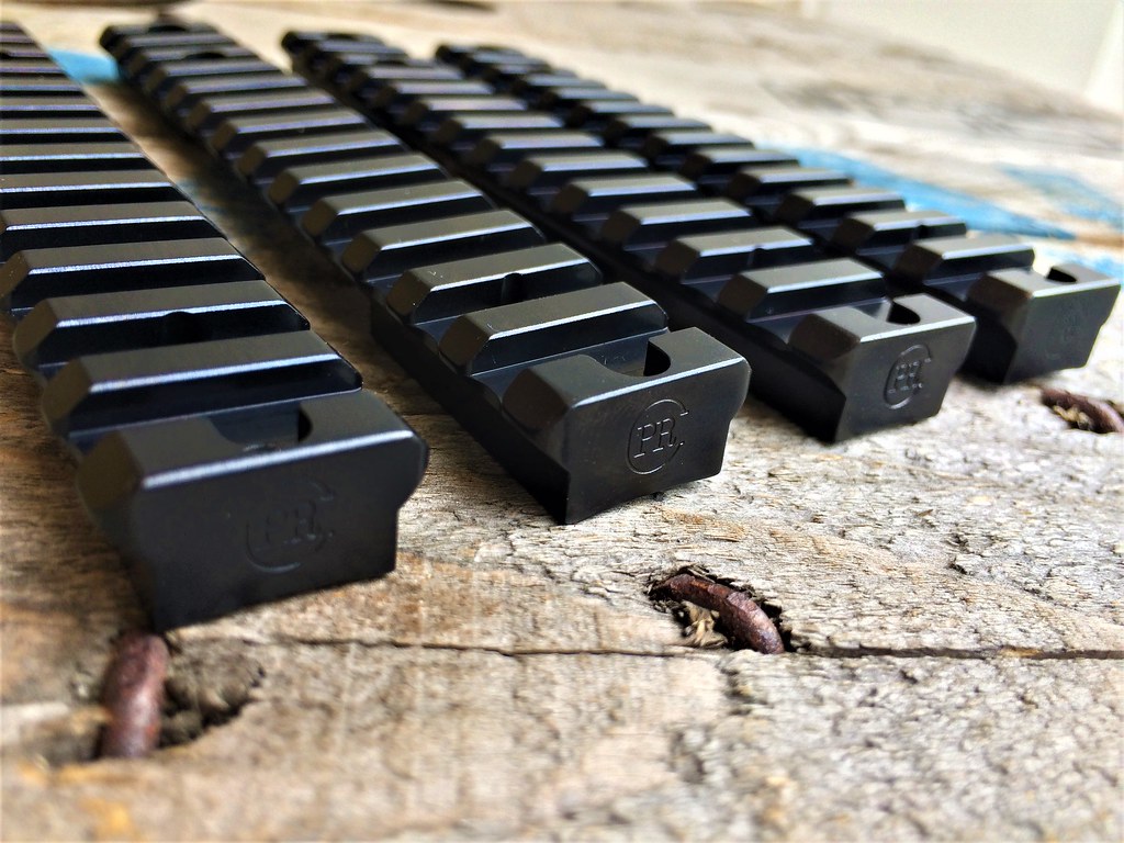

And I am pleased to announce: Remington 700 Long Action rails are now part of my "in stock" line up; both in Stainless and Blued.

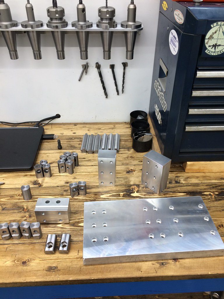

Building a business is a never ending "chicken/egg" juggling act of working on jobs for customers to create income/keep the lights on, and developing processes/products/tooling within the business to increase its capability, flexibility and profitability. (If anyone has that balance figured out I'm all ears!)
I dedicated a chunk of last week to the later. These parts are going to be a series of fixtures (along with a custom sub plate) for making Picatinny rails that will allow me to process 8 rails at a time, while maintaining the ability to handle rails for (theoretically) any make/model of firearm and will ease the setup/manufacture of one-off custom rail projects!

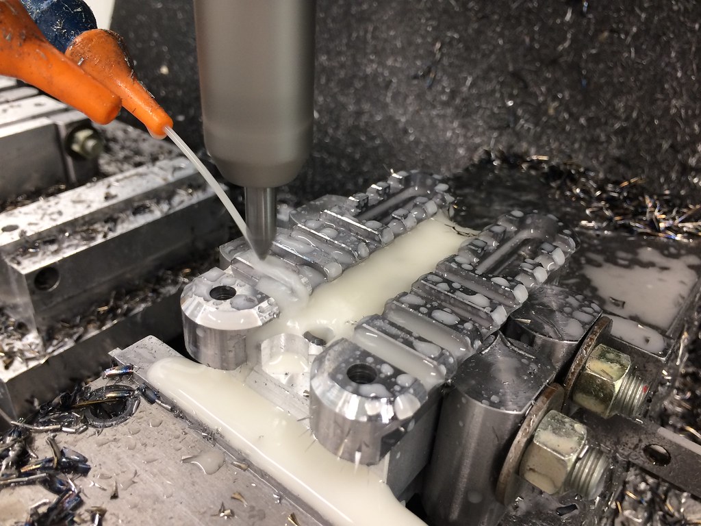

here are those fixtures all finished up!

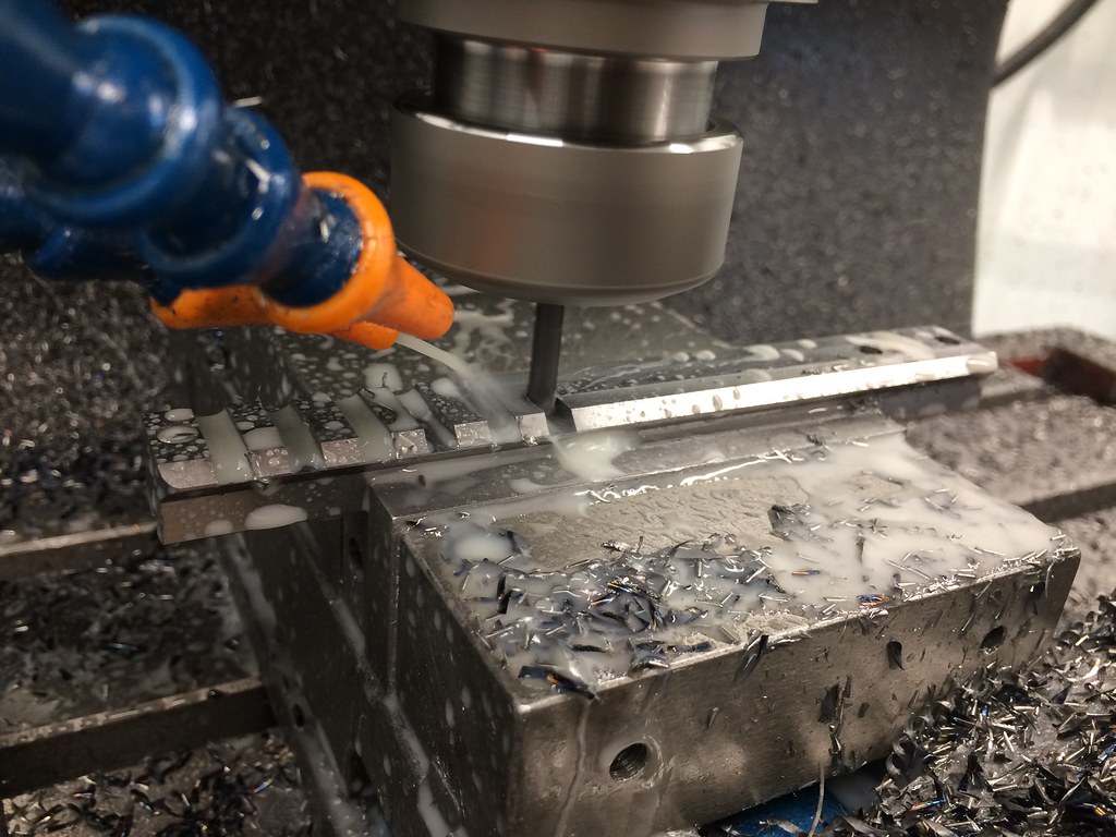

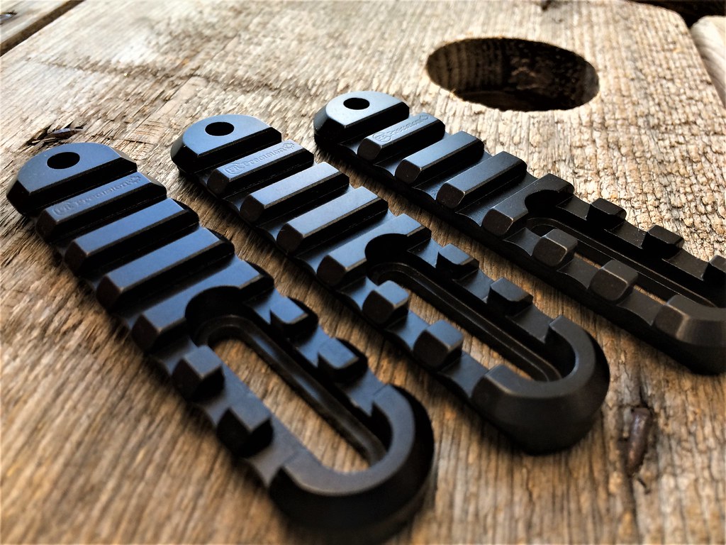

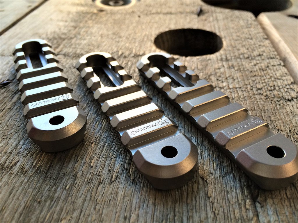

Unfortunately The only action shot I got of them is this one; a fourth, extra short fixture for doing the last op on these lil guys!
These are 3 1/2" fore-end under rails for bipod/accessory mounting.
Any chance we see the 3 1/2" fore-end under rails in aluminum at any point? I have a Manners hunting stock with odd sling stud spacing that I'd love to replace with one of these.

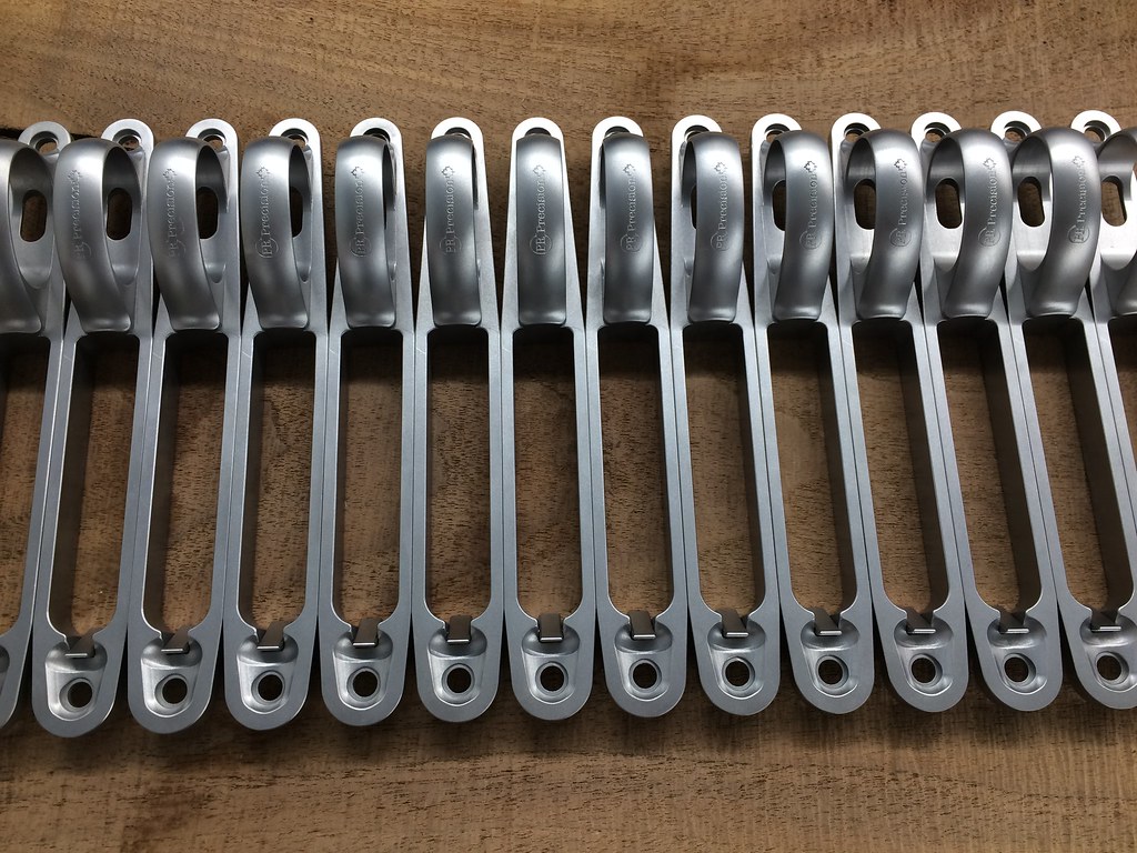

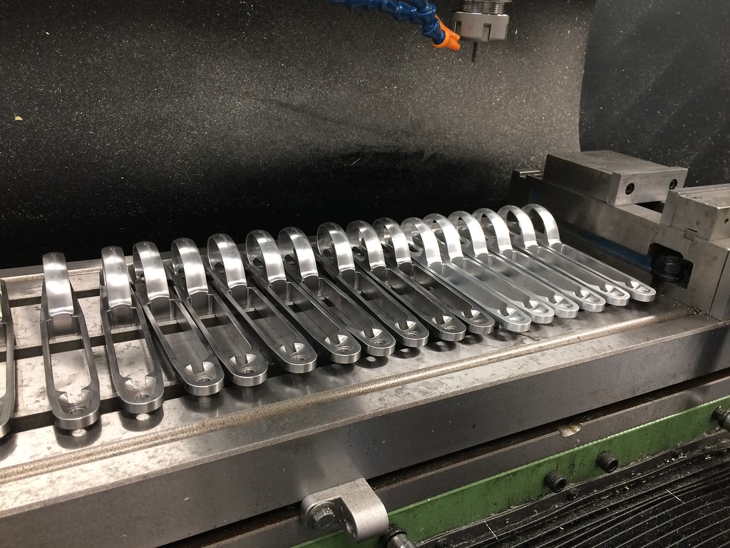

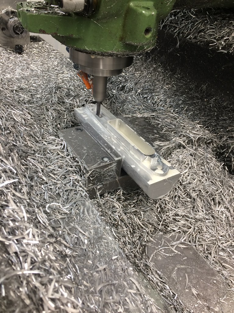

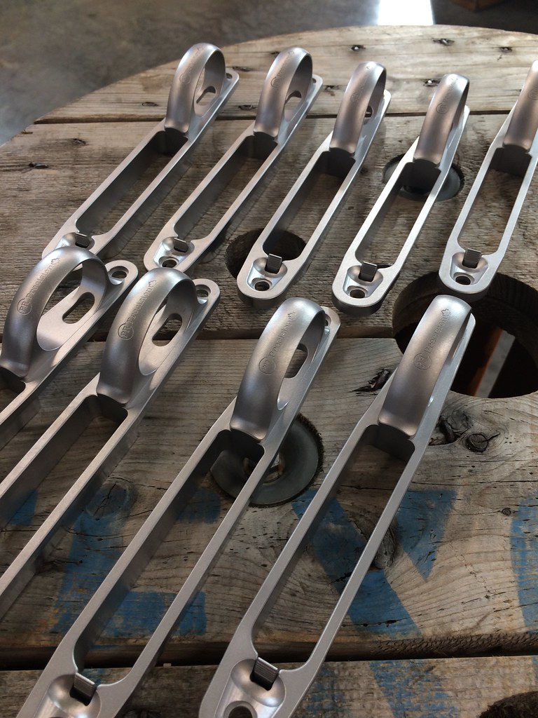

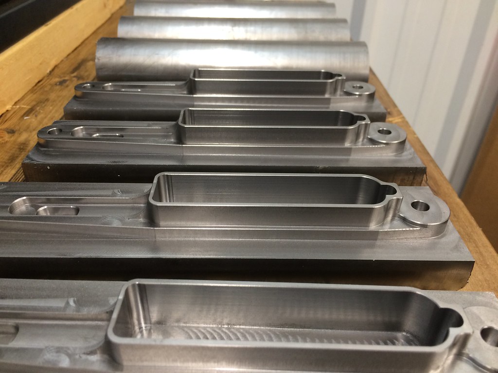

Its been a busy month between custom jobs, rush jobs for hunting season as well as getting out hunting myself. I am excited to say both stainless and aluminum have arrived for my next production run of Tikka Bottom metal, and chips are starting to fly! I've got quite a few pre-orders for this batch but there's still time to put your name on one!

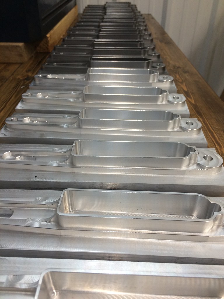

The chips have been flying!
Half a dozen aluminum orders in the mix really stand out!
The last of the engraving is finished up; Beadblasting, assembly and test fitting is underway! First units are shipping today.

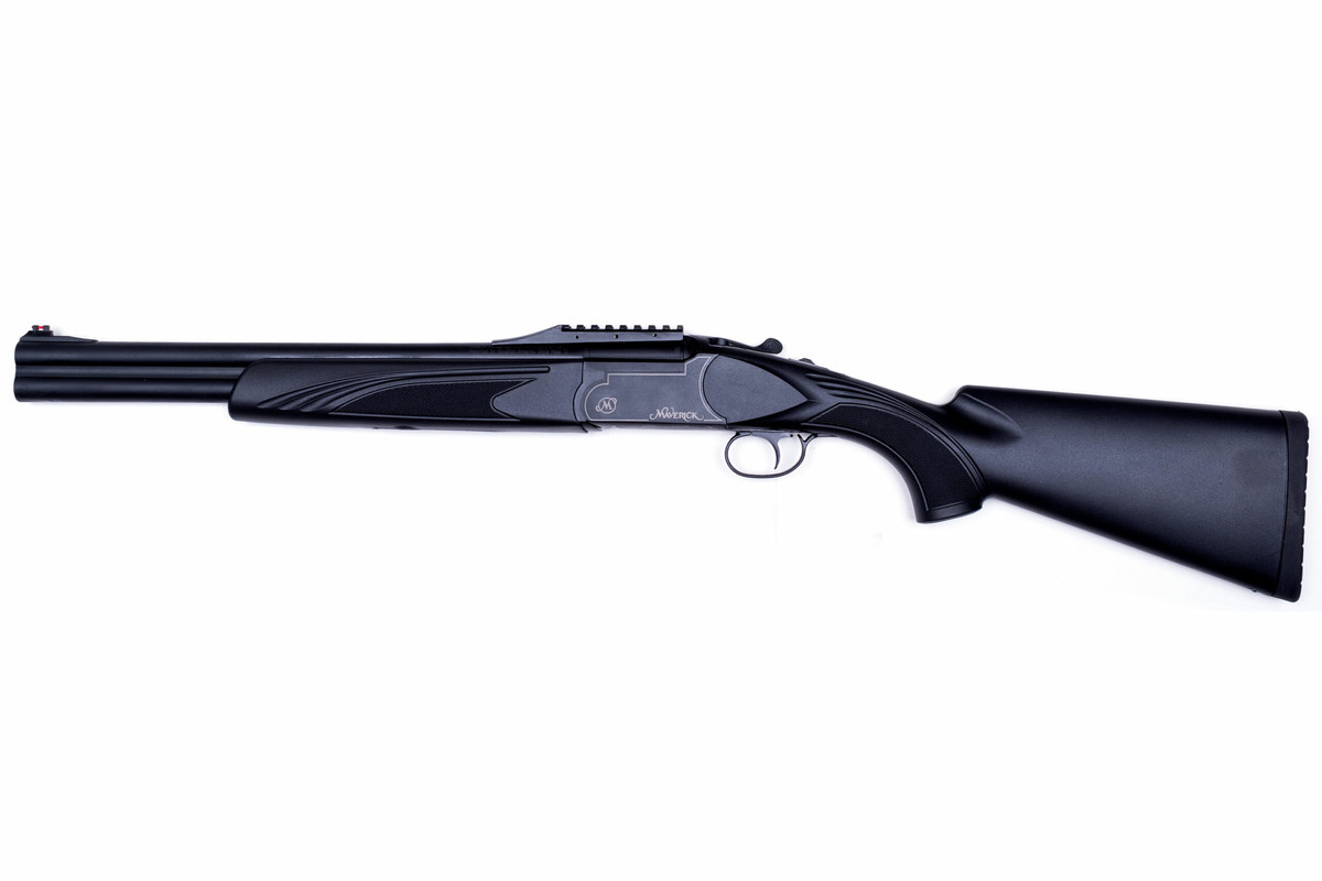

A re & re for a Mossberg HS12 o/o. Needs bluing/ would like to go to wood stock & fore end, a shell holder like the "rifle" on your website would be nice add if possible . PM when you have a moment. Ty in advance for your time.
Sure thing! PM sent.

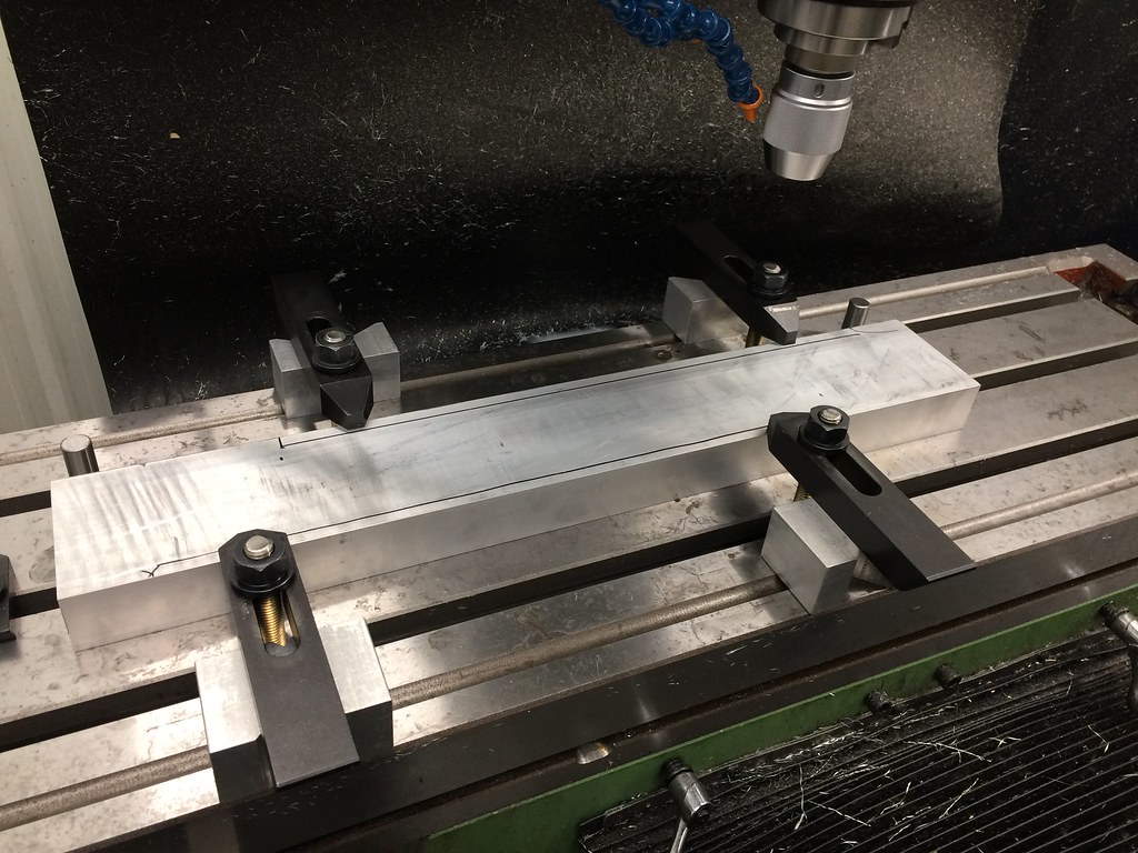

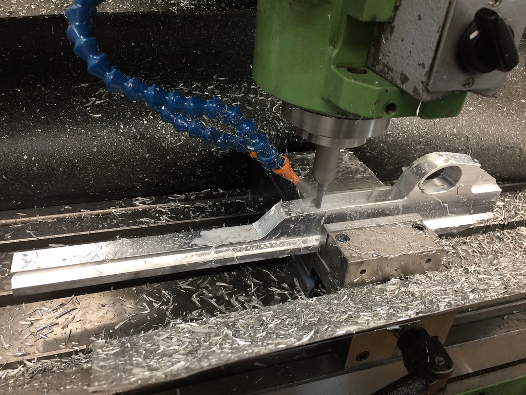

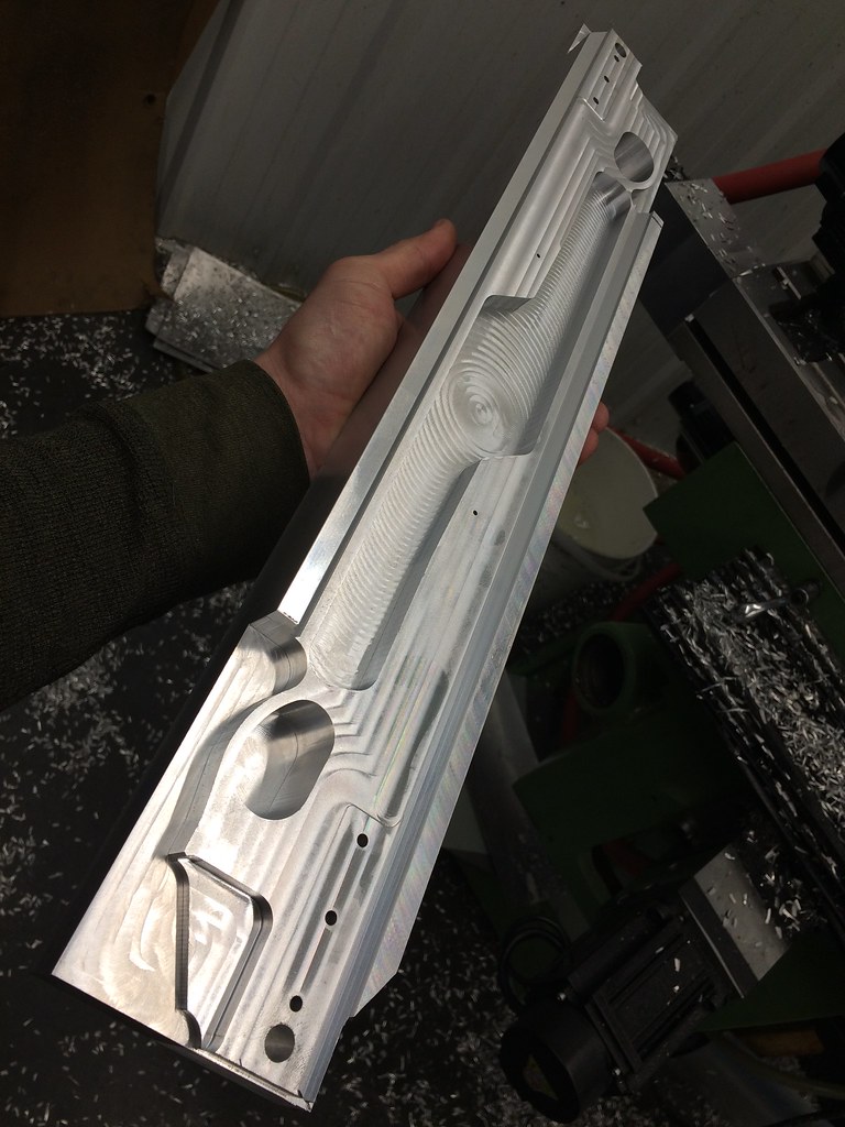

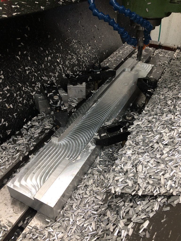

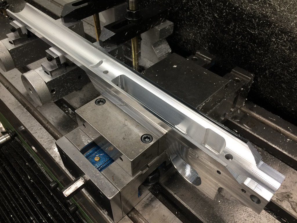

This is a fun one! I'm designing/building a custom chassis for one of my good customers.
LOOOOOTS of chips being made, really fast!
For an extra few inches of material, I was able to nest a second part, almost for "free". This is excellent as it gives me a "scrapable test piece" to prove my programs and make adjustments on.
