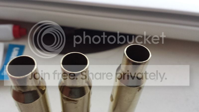

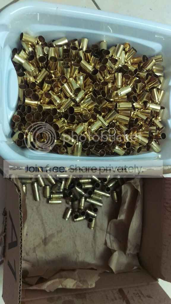

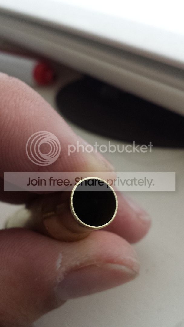

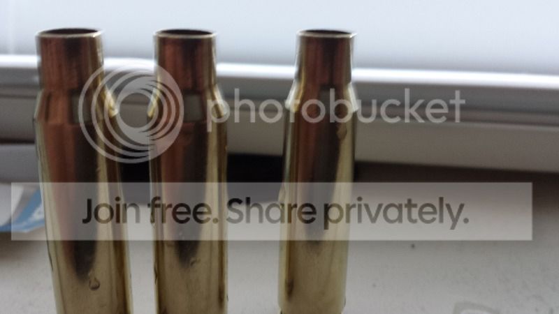

I used the plastic bottle one marked original detergent booster. I use 2 teaspoons, 2 more each of dawn and tide cold water into Frankford arsenal tumbler, for 60 minutes with 10 pounds of pins and 170 308 cases. With 5 pounds of ss I had major peening, with 10 is minimal and clean in a hour.
So are you saying you use ten pounds of pins instead of just five pounds of pins? Could you happen to post a picture of the results. I just use five pounds of pins and 1 and 1 of dawn and the regular lemi-shine and hot water. I run them for about a hour also and I don't really see the peening.

Thanks bsand. I've looked at mine with a magnifying glass(getting old) and I really can't see it??
