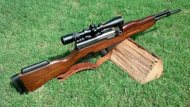

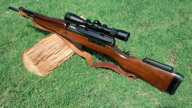

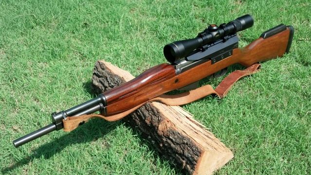

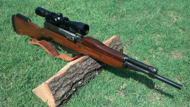

Bought this one some time ago locally for $100. The barrel was chopped at 16.5" at 70° and no crown. The previous owner had also camo painted the stock and added a large black skull to both sides. ::)
I fixed the muzzle, added a d&t Capco mount holding a Nikon Pro Staff, made a handguard that covers the RSB, a solid ebony cheek riser, and an ebony butt extension.

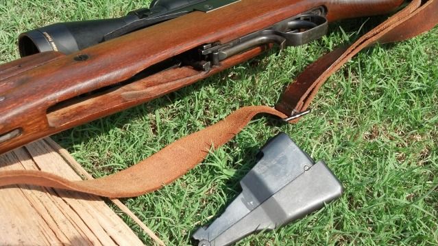

Due to not having access to the stripper clip guides on the carrier, the fixed 10 rounder was made "drop free" or "detachable" via removal of the retaining collar and spot welding the swing portion of the mag in place. Topped it off with my custom made Talon extended mag release and the system works great.
Ok now I'm curious about the magazine setup: is this a Chinese SKS-D with standard Kalash mags? or is that a modified magazine to fit standard SKS?
Looks like a restricted/modified duckbill to me. The rifle does not have the AK mag release mechanism.
So its the 5/30 duck bill. There was no modification needed at all. It was plug and play. I forget the brand. The SKS is just a regular Russian refurb.
Ive tried the TAPCO mags before in other SKS's (in original wood stock, in tapco stock, in archangel stock) and almost always the crapco plastic mags need modification or filing some where to run/fit right. After 5 SKS's trying almost all available after market parts. I have come to realize that you should just leave it as is unless you want headaches. Always something needing to be tinkered with. Never any actual improvements. I got bored one day and decided to do this to the sks, the hand guard cover took a bit more to do then I would have liked but that's fine, the mag was going to be for pictures only because I expected to have to #### with it to make it fit but there was no issues with mine and it actually runs fine surprisingly. Out of all my SKS's other then the one in in original version this one is the most reliable and cool looking I think.
Due to not having access to the stripper clip guides on the carrier, the fixed 10 rounder was made "drop free" or "detachable" via removal of the retaining collar and spot weldRing the swing portion of the mag in place. Topped it off with my custom made Talon extended mag release and the system works great.
