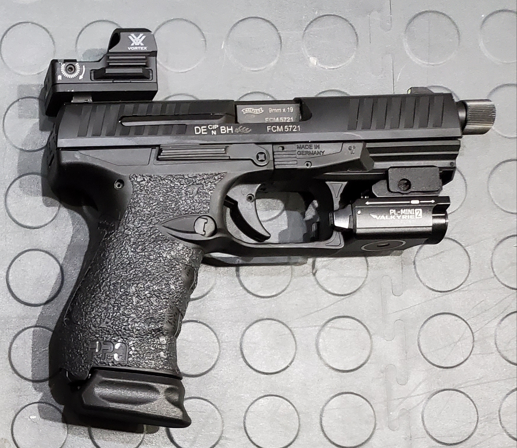

I went with a Vortex Venom 6MOA and have at least 1K using the sight. It has held zero for me. The Vortex Viper would be my choice now as you can replace the battery from the top without removing the sight. Either way for IDPA and IPSC the Vortex product has worked for me. Their warranty is outstanding. Not as expensive as some but meets my needs. The sight was on my PPQ MAtch but now resides on my SIG XFive.

I have 7 x Trijicon RMRs, 4 x Leupold Delta-Point Pros, 3 x Holosun HS507Cs, 3x Burris Fastfires, 2 x Aimpoint ACROs, and 1 x Vortex Razor Miniature Red Dot Sights (MRDS) mounted on a wide variety of modern handguns due to my fixed-focus eyesight post-cataract surgery. I consider myself an early-adopter with considerable MRDS experience spanning several years. My sights are mounted in a combination of dovetail mounts and milled slides, with some of the newest handguns (eg. FN 509T) being equipped with factory adapter plates. Dot sizes range from 2 MOA to larger dots, with various reticles including the Leupold 7 MOA Triangle and the Holosun's 32 MOA Circle-Dot.

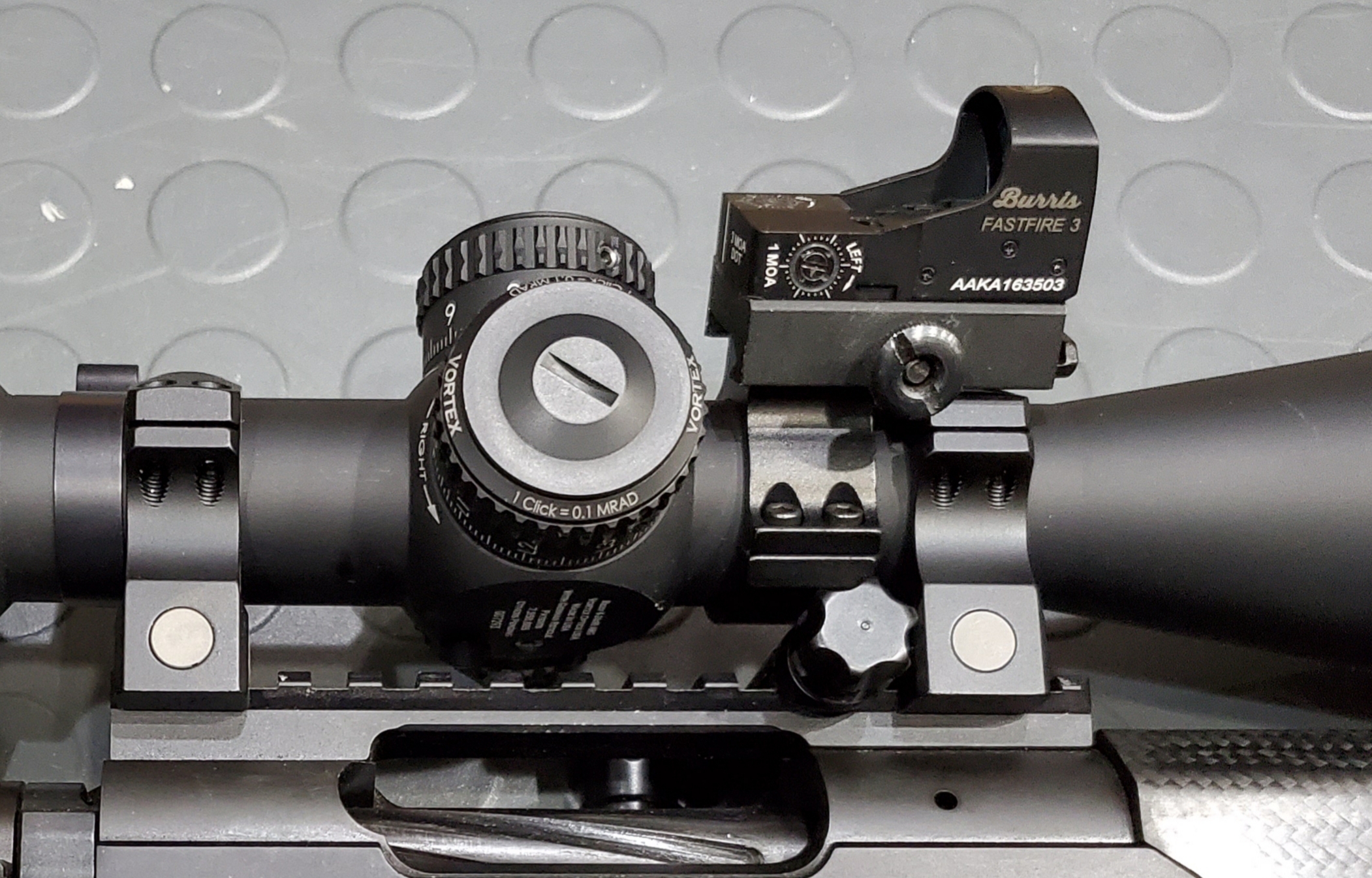

The Burris Fastfire III is an economy-priced MRDS that will set you back approximately ~$350 The last time I checked. The Fastfire is lightly-built in contrast to the sights that I have mentioned thus far, and I doubt that it would take much abuse to break it. The dot has a single brightness button which adjusts upwards with 4 settings including an auto-adjust feature and the Off setting. This is a sight that I would rate as suitable for range use on a plinker, NOT for duty or home defence use. I have long-since downgraded my Fastfires to accessory red-dot status on my spotting scope and my high-powered precision rifle-scopes.
