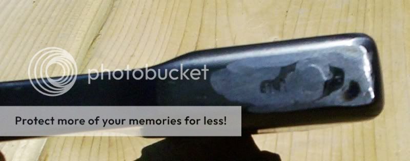

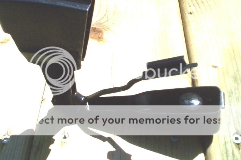

Norc SKS, looking at the Russian SKS45 ID thread(I assumed importers would pin the same way), the pinning doesn't match any of em. Wondering if anyone has a similarly pinned mag.
This is typical of mags on Type 56 imported by Bell. Best blocking job of all, extension on the mag spring rivet restricts follower arm travel. Clean, effective and does not alter the external appearance.
sks
An importer from Quebec, I pinned 2000 for a western importer with the carrier pinned with a 5/16" pin, he sent me 600 to complete and repair for him.
Agreed. Effective and unobtrusive.
MUCH better than the externally welded alterations on the rifles being currently sold.
