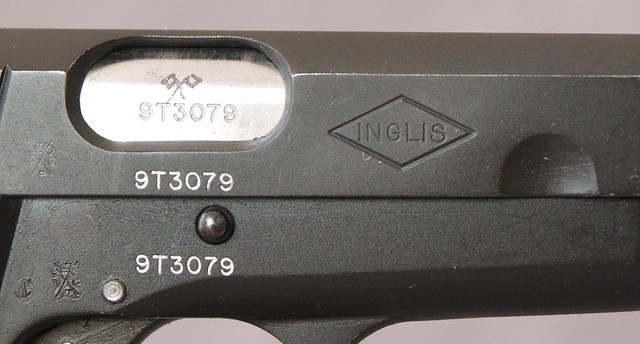

It's hard for me to tell from the photos if the serial number is still 'in the white' or if the pistol has been re-finished. It appears possible that finish might be original but in rough shape. I would try putting some oil over the serial number on the slide and frame and maybe it will lift out some of the crud to better view the serial number.
This is what the serial number should look like on an original finish Inglis hi-power:

The serial numbers appear to still be in the somewhat dirty white.. the sights are marked to 500 (m?) The slide to frame fit is decently tight, the barrel is tight in the slide and the barrel lugs are sharp like new... the stock is high quality, nice walnut wood I believe and the metal looks like its finished in old park thats turning greenish like the WW2 garands do, the metal retainer in the rear of the stock that fits into the back of the browning is blued, its marked SA LTD over 1944 and the stamp is oval with some symbol I can tell and the numbers 57 in it. No other serial numbers of any sort on the stock that I can tell.

The original finish on Inglis hi-powers is a black phosphate. They are significantly darker than the factory parkerizing found on USGI weapons such as Colt M1911A1's. They do occasionally look 'grey' in photographs.

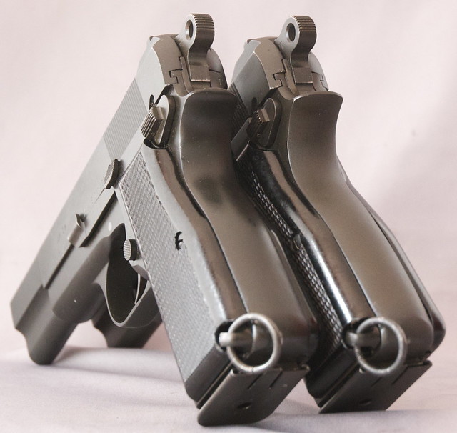

Mines missing the lanyard ring.. are they impossible to find? I paid $1400 Cnd for the gun and stock for my collection, was curious in if I got burned, I hate going in blind on guns I dont know anything about LOL. Thanks for all the info guys :)

I think you did OK....fair to both parties.
According to Clive Law's book on these pistols, yours was made approx Sept of 45. Odds are that yours went to another country than China as part of mutual aid. The Canadian army liked to pawn off the non-standard no1 CH guns to other coutnries, and even to the Canadian navy so they did not have to deal with the variations.
